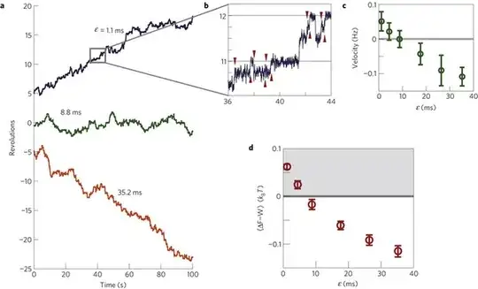

Shoichi Toyabe; Takahiro Sagawa; Masahito Ueda; Eiro Muneyuki; Masaki Sano (2010-09-29). "Information heat engine: converting information to energy by feedback control". Nature Physics 6 (12): 988–992. arXiv:1009.5287. Bibcode:2011NatPh...6..988T. doi:10.1038/nphys1821. "We demonstrated that free energy is obtained by a feedback control using the information about the system; information is converted to free energy, as the first realization of Szilard-type Maxwell’s demon."
Now, let's think about this in-the-laboratory Szilard engine as a thought experiment and note particularly that it definitely scales the possibility of realising a Szilard engine up to the nano-technology, or more importantly, the molecular biology and microbiology scale.
Now for the grandest experiment of all time: the evolution of life on Earth. After 3 billion (and likely more like 4 billion) years of evolution, wherever biologists look, the basic powerhouses driving life (photosynthesis, mitochondrial ATP production from chemical energy ingested by cells and so forth) are well understood and almost certainly universal. It seems to me, that if there were a way around the second law through biological nanomachines (particularly with a variation on the Szilard engine, since the experiment above shows how it can scale to biological systems), evolution would almost certainly have found it by now and this second-law-violating process would be meeting all the needs of the creatures that evolved it. One could imagine that such creatures would swiftly become utterly dominant in the biosphere, sweeping all else aside. But this hasn't happened yet, although I believe there is an animal who delusionally believes that all its needs can be gotten for free from the environment, and that is just what that animal seems to be doing to the biosphere around it, so we have some anecdotal experiment evidence about how a second law violating animal might behave and how it might affect the biosphere. And yet, after all this time of life on Earth, all the creatures are using energy deriving processes altogether in keeping with the second law. Indeed the weird life (tube worms and the like) discovered in the last few decades around "volcanic smokers" deep in the ocean, almost poetically seem to be paying homage to Carnot's thought experiment, drawing work from heat and chemical potential blasting out of their central, hot life-giving "smoker" and casting the excess entropy out into the icy darkness surrounding their tiny thriving neighbourhood.
There are no biological perpetual motion machines of the second kind, and this is an extremely strong experimental null result. In particular, I believe it likely, given the experimental Szilard engine, that the Earth as an evolutionary computer (in the spirit of Douglas Adams) has likely "thought about" variations on the Szilard engine realised in molecular machines many times, so the null result is particularly pointed as a confirmation of Landauer's principle, a particularly pithy equivalent of the second law. An excellent paper showing exactly how the Szilard engine / Maxwell Daemon must heed the second law is Charles Bennett, "The Thermodynamics of Computing: A Review", Int. J. Theoretical Physics, 21, 12, 1982. Bennett used reversible mechanical gates ("billiard ball computers") to thought-experimentally study the Szilard Engine and to show that Landauer's Limit (the minimum amount of work needed for computation) arises not from the cost of finding out a system's state (as Szilard had assumed) but from the need to continually "forget" former states of the engine by casting the information-theoretic Shannon entropy of the sequence of gas particle states recorded by the Daemon out into the surrounding world encoded as increased complexity there.
