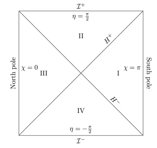

These coordinates cover only the region of dS space which is in causal contact with a static observer. The coordinate singularity in turn describes the two event horizons that appear (future and past) which is a feature of dS space. You can readily see this in the relevant Penrose diagram:
with the future and past horizons being $H^{+}$ and $H^{-}$ respectively, and the region covered by static coordinates is region I.
For your case, it might take some work to figure out exactly an appropriate coordinate system where the singularity is lifted, but from its form it seems that it is doable. On the other hand, $\Phi(r)$ can only be removed via a conformal/Weyl transformation, hence the stipulation that it is finite is necessary to keep the metric non-singular.
