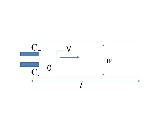

For a more readily imagined scenario, we think of a long, thin loop so that $\ell \gg w$ where $\ell$ is the length of the loop and $w$ the approximately uniform distance between the conductors as below.
Shorted Capacitor
At very short timescales, less than $w/c$, the top wire behaves as the general waveguide just describes and radiates as a superposition of single-wire waveguide modes across the width $w$ to begin interaction with the lower wire. Now the wire pair, being approximately translationally invariant, also has a system of waveguide modes, amongst them the TEM "transmission line modes". See the Wikipedia page on TEM transmission lines and also my discussion of an approximately TEM system here towards the end after the heading "Approximations to the General Description and a "Circuit" Description of the System". The radiation across the circuit's width quickly establishes the TEM mode of the pair as the dominant mode: since all the other modes are very lossy (which I'll show when I add the mathematical form for them above), and have much greater imaginary propagation constants (much lossier) than the TEM mode, this happens over a very short length of line indeed.
So now, at timescales greater than a few $w/c$ we have a single voltage step function $\theta(z-c\,t)$ (where $\theta$ is the unit step, and $z$ the axial distance along the loop propagating along the pair as shown. When it reaches the dead short at the other end, a reflected wave propagates back. When the backpropagating wave hits the capacitor, there is another reflexion and so forth, as governed by the reflexion co-efficients which the Wiki article tells you how to calculate. The modes are slightly lossy, so each "bounce" wave is a little less intense than its forerunner, and the sum of the waves slowly builds up to the "circuit analysis" model of the system, wherein the capacitor's voltage decays with a time constant $R\,C$ where $R$ is the Ohmic resistance of the loop.
