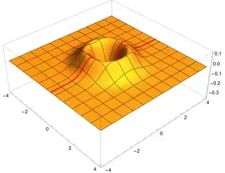

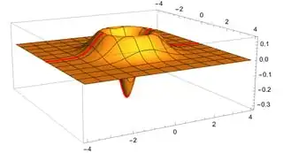

To illustrate this, look at the following two figures:
They show the same quasi-distribution function, which contains regions of negativity near the center, as illustrated in the right figure: the near the central "anti"-peak the quasidistribution is clearly negative. However, integrating this quasi distribution along the line $p$ at $x=-2$ (shown on the left figure by the red line) yields
$$ \int dp W(x=-2,p)=\vert\psi(x=-2)\vert^2 > 0 $$ so even if there are regions of negativity the probability of finding the system near $x=-2$, which is $\vert\psi(x=-2)\vert^2\,dx$, is of course positive. For completeness here $\psi(x)$ is in fact $\psi_1(x)$, the wavefunction of the $n=1$ harmonic oscillator state.

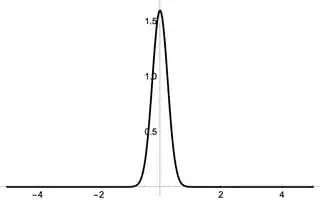

To make absolutely explicit the difference between a probability density and a probability, consider the following normalized Gaussian wavefunction:
$$ \psi(\sigma)=\frac{e^{-x^2/(2\sigma)}}{(\pi \sigma)^{1/4}} \tag{1} $$ for $\sigma=1/8$. $\psi(1/8)$ is a perfectly legitimate wavefunction for a particle in a harmonic oscillator. The resulting probability density $\vert \psi(1/8)\vert^2$ is $>1$ near the origin:
but of course this is not a problem. Since $\int_{-\infty}^{\infty} dx \vert \psi(1/8)\vert^2=1$ and $\vert \psi(1/8)\vert^2 \ge 0$ everywhere, it follows that, for any subinterval $[a,b]$: $$ \int_a^b dx \vert \psi(1/8)\vert^2 \le 1 $$ even if $\vert \psi(1/8)\vert^2$ can be greater than one somewhere. Nobody in their right mind would suggest that, because the probability density $\vert \psi(1/8)\vert^2$ is greater than 1 somewhere, probabilities greater than 1 are possible possible.
