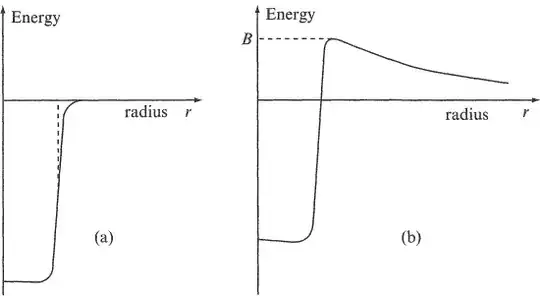

One we have agreed that the nucleon interaction can be approximately described by a potential, the same reasoning applies as in the case of a hydrogen atom, although with correction for the shape of the potential and the fact that the nucleons have approximately equal masses - whereas in an atom the center-of-mass can be safely assumed to coincide with the nucleus. Here is a figure taken from these notes:
What might be confusing is that realistic nuclear potentials are quite sharp, and often depicted as nearly square potential wells:
This is however only a convenient approximation.
