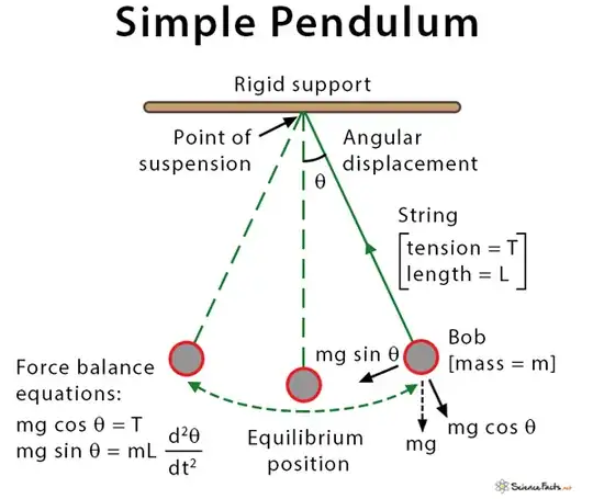

Only if the target force has a component force in the direction of movement, the force does work to the object.
Here no component of tension acts in the direction of movement of pendulum, so the work done by tension is $0$.
Simple pendulum
CN_lift
