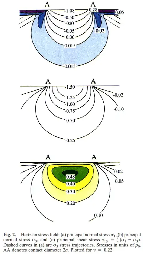

Now in the references, B. R. Lawn, A. Franco, and P. D. Warren, et. al. these equations are used to argue for that cone fracture can be understood. For instance in B. R. Lawn Fig. 2 looks like this: Fig. 2 in B. R. Lawn
I have then read that this diagram is supposed to explain cone fractures because outside of the contact area AA $\sigma_1$ (most positive principal stress) changes from being compressive to tensile.
In H. Chen et. al. there is a relationship between the direction of the cone crack. In the z-r plane this relationship is $$\frac{dz}{dr} = \frac{\tau_{rz}}{\sigma_1-\sigma_{rr}}.$$
My issue is that I do not understand how the figure explains cone cracks, and how the above relationship comes about. The above relationship looks alot like the angle necessary to rotate the coordinate system to obtain principal stresses. Finally, I have a vague idea of that the cone cracks are supposed to follow the trajectories of one of the principle stresses but I do not understand why.

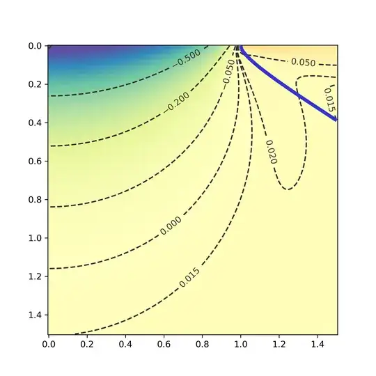

When I compute a streamline starting in the surface at the end of the contact radius, I get the following enter image description here
Given that I am obtaining the same streamline that the authors, I would guess that it might be a typo.
