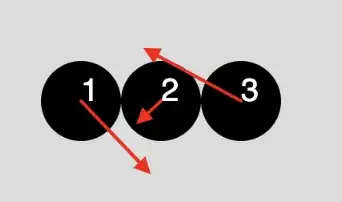

It's easy to show that energy is conserved for this method when the bodies are aligned.
Since tangential components of the velocities stay the same, they can be ignored in the conservation of energy law. So all velocities in the following formulas are velocities along horizontal axis. Also, to simplify, suppose all bodies have the same mass, than: $v_{1f}^2 + v_{2f}^2 + v_{3f}^2 = v_{1i}^2 + v_{2i}^2 + v_{3i}^2$ where $v_{kf}$ - final velocity of the body $k$, $v_{ki}$ - initial velocity of the body $k$
I wrote a MATLAB script that proves that
% impulses
syms j12 j23 positive
% initial velocities
syms v1i v3i v2i positive
% final velocities
v2f = v2i + j12 - j23 v1f = v1i - j12 v3f = v3i + j23
% Newton's impact laws laws = [v2f - v1f == -(v2i - v1i) v3f - v2f == -(v3i - v2i)]
% Express j12, j23 as functions of initial velocities js = solve(laws,[j12,j23])
% Conservation of energy law K = v1f^2 + v2f^2 + v3f^2 - v1i^2 - v2i^2 - v3i^2 == 0;
% Substitute symbols j12, j23 in the energy law for the functions proof = subs(K, j12, js.j12); proof = subs(proof, j23, js.j23)
%returns symtrue => kinetic energy is conserved simplify(proof)

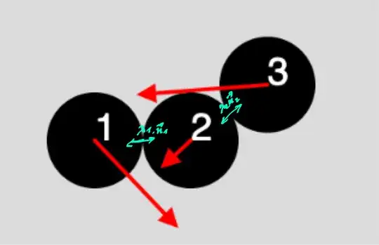

I tried splitting velocity of body 2 into normal and tangential components: $v_{2n1f}$ -normal velocity relative to body 1, $v_{2n3f}$ - normal velocity relative to body 3, $v_{2t1f}$ - tangential velocity relative to body 1. Since bodies are not aligned, $v_{2t1f}$ depends on $j_{23}$. Tangential components of velocities for bodies 1 and 3 stay the same and can be ignored, so $v_{1f}$ and $v_{3f}$ - normal components. Formulas I used: $$v_{1f} = v_{1i} - j_{12}$$
$$v_{2n1f} = v_{2n1i} + j_{12} - j_{23}(\vec{n_{23}} \cdot \vec{n_{12}})$$ $$v_{2t1f} = v_{2t1i} - j_{23}(\vec{n_{23}} \cdot \vec{q_{12}})$$ $$v_{2n3f} = v_{2n3i} - j_{23} + j_{12}(\vec{n_{12}} \cdot \vec{n_{23}})$$
$$v_{3f} = v_{3i} + j_{23}$$
$\vec{q_{12}} = \frac{\vec{v_{2t1i}}}{v_{2t1i}}$, so it's a unit vector, perpendicular to $\vec{n_{12}}$
Maybe the formulas are wrong or/and I' missing something. I wasn't able to get the proof that energy is conserved in the same fashion I did for the aligned case using MATLAB.

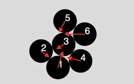

And there are even more complicated cases, where each body has more than one colliding contact point:
I'm aware that the method described in the paper makes many assumptions, which are not realistic. I understand that it's an approximation meant to look plausible for some configurations of bodies. Yet, somehow it does conserve energy.
So, my question is: given that the momentum of the system is conserved and Newton's impact law is satisfied for each colliding contact point, is it possible to prove that kinetic energy of the system is conserved for the arbitrary system of colliding objects? For example:

$\def \b {\mathbf}$ I use this theory
(Simulating rigid body collisions in 3d)
for this example you obtain these equations
$$g_1=m_1\,(v_1-u_1)=-\lambda_1\,n_1\\ g_2=m_2\,(v_2-u_2)=+\lambda_1\,n_1-\lambda_2\,n_2\\ g_3=m_3\,(v_3-u_3)=+\lambda_2\,n_2$$
the kinetic energy is: $$2\,T=\sum_{i=1}^3\,m_i\,(v_i-u_i)\,(v_i+u_i)=0$$
substitute $~v_i-u_i~$ from $~g_i~$ and because $~\lambda_i\ne 0~$ you obtain two additional equations.
$$(v_2-v_1)\cdot\,n_1+\epsilon\,(u_2-u_1)\cdot n_1=0\\ (v_3-v_2)\cdot\,n_2+\epsilon\,(u_3-u_2)\cdot n_1=0$$
altogether 11 linear scalar equations for the unknows
$~v_1~,v_2,v_3~,\lambda_1~,\lambda_2~$
you can check with the solution that the kinetic energy (with $\epsilon=1$) is conserved.
$$2\,T=\sum _{i=1}^3\,m_i\,(v_i^2-u_i^2)=0$$
and the linear momentum $~P~$ (bevor you solve the equations)
$$P=\sum _{i=1}^3 g_i=0$$
solve this linear equations \begin{align*} &\mathbf A\,\mathbf x=\mathbf b\\ &\mathbf A=\begin{bmatrix} m_1\,\mathbf I_3 & 0\,\mathbf I_3 & 0\,\mathbf I_3 & \mathbf n_1 & 0\,\mathbf I_3 \\ 0\,\mathbf I_3 & m_2\mathbf I_3 & 0\,\mathbf I_3 & -\mathbf n_1 & \mathbf n_2 \\ 0\,\mathbf I_3 & 0\,\mathbf I_3 & m_3\mathbf I_3 & 0\,\mathbf I_3 & -m_2\mathbf I_3 \\ -\mathbf n_1^T & \mathbf n_1^T & 0 & 0 & 0 \\ 0 & -\mathbf n_2^T & \mathbf n_2^T & 0 & 0 \\ \end{bmatrix}_{11\times 11}\\ &\mathbf b=\begin{pmatrix} m_1\,\mathbf u_1 \\ m_2\,\mathbf u_2\\ m_3\,\mathbf u_3 \\ \epsilon\,\mathbf n_1^T(\mathbf u_1-\mathbf u_2 )\\ \epsilon\,\mathbf n_2^T(\mathbf u_2-\mathbf u_2 ) \\ \end{pmatrix}_{11\times 1}\\ &\mathbf x=\begin{bmatrix} \mathbf v_1 \\ \mathbf v_2 \\ \mathbf v_3 \\ \lambda_1 \\ \lambda_2 \\ \end{bmatrix}_{11\times 1}\\ \end{align*} and substitute the solution in the kinetic energy $~(\epsilon=1)~$ you obtain $~2\,T=0~$

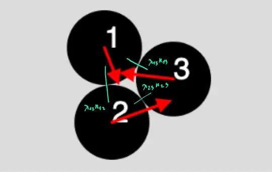

this example
\begin{align*} &g_1=m_1\,(v_1-u_1)=-\lambda_{12}\,n_{12}-\lambda_{13}\,n_{13}\\ &g_2=m_2\,(v_2-u_2)=+\lambda_{12}\,n_{12}-\lambda_{23}\,n_{23}\\ &g_3=m_3\,(v_3-u_3)=+\lambda_{13}\,n_{13}+\lambda_{23}\,n_{23}\quad\Rightarrow\\ &P=\sum_{i=1}^{3} g_i=0 \end{align*} and \begin{align*} & \left[(v_2-v_1)+\epsilon\,(u_2-u_1)\right]\cdot n_{12}=0\\ & \left[(v_2-v_3)+\epsilon\,(u_2-u_3)\right]\cdot n_{23}=0\\ & \left[(v_3-v_1)+\epsilon\,(u_3-u_1)\right ]\cdot n_{13}=0\\ \end{align*}
