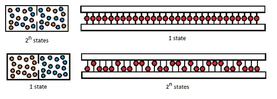

However, it's not a good explanation of the Maxwell's demon argument. For this, consider the classic case of a demon separating hot and cold molecules, using an abacus for data storage.
Maxwell's demon
The demon measures the temperature of each gas molecule, and reduces the $2^n$ states of the well-mixed gas to $1$ state. At the same time, he transforms the $1$ state of an empty memory store to the $2^n$ possible states of a full one.
Now we can see that the demon is faced with exactly the same problem when it comes to erasing the memory store. The beads of the abacus are divided into two groups representing 'hot' and 'cold'. In order to erase the data, the demon has to measure the state of each one so it knows how to perform the transformation to the 'empty' state. All we have done is moved the problem, not solved it.
This is where Landauer's principle comes from - erasure of a data store is exactly the same sort of problem as separating a mix of hot and cold molecules, and thus requires an external source of entropy increase to perform the erasure, such as heat dissipation. Thus, Landauer's principle assumes the demon's impossibility, and assumes the standard thermodynamic formula for heat engines to calculate an amount of energy to dissipate.
