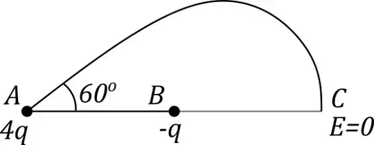

While trying to solve this problem, I found that the point $C$ where $\mathbf E=0$ (excluding points infinitely far away) to be collinear with $A$ and $B$ and the field line is approximately as shown below.
My hang up at the moment is this: how can you prove that the field line passing through $C$ will pass this point perpendicular to the central line?

Given the symmetries, we can consider developments of the field around the point of equilibrium of the following form, odd in $r$ for the radial component, even for the $z$ component:
$E_z (r,z)=a_1 (z) r^2+a_2 (z) r^4+⋯$
$E_r (r,z)=b_1 (z)r+b_2 (z) r^3…$
As $dz/dr=E_z/E_r $, we have to find the limit of the slope when one approaches the point of equilibrium,that is the limit of $(a_1 (z) r^2+a_2 (z) r^4…)/(b_1 (z)r+b_2 (z) r^3…)$ when $r$ tends to $0$. As this limit is $dz/dr=0$, the angle is $90°$.
For the other angle, it should be noted that the field lines inside the cone limited by all the lines from A to E return towards the charge $-q$. Only the outer field lines go to infinity.
The flux of the electric field around the charge $4q$ is $(4q/ε_0)$
The solid angle corresponding to the field lines external to the tube which joins A to C is $Ω=2π(1+cos⁡(θ))$ and the corresponding flux is $(4q/ε_0)(Ω/4π)=(2q/ε_ 0)(1 +cos⁡(θ))$ (since, Very close to the $4q$ charge, we can pretend we have a single point charge).
But this flux is also the total flux through a large sphere which surrounds the two charges. So we will have: $(q/ε_0) 2(1+cos⁡(θ) )=3q/ε_0$ or $cos⁡(θ)=1/2$
Hope it can help.

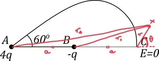

how can you prove that the field line passing through C will pass this point perpendicular to the central line?
The potential at position $X$ is $V_{\rm A}(r_4)+ V_{\rm B}(r_1)$ and $r_1$ and $r_4$ can be written in terms of $a,\,r$ and $\theta$ with $r\ll a$.
You need to show that $\partial V/\partial \theta =0$ for $\theta =\pi/2$ if $r\ll a$.
This method has the advantage of using a scalar function (potential) rather than a vector function (field strength).
