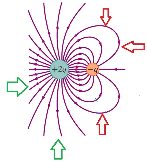

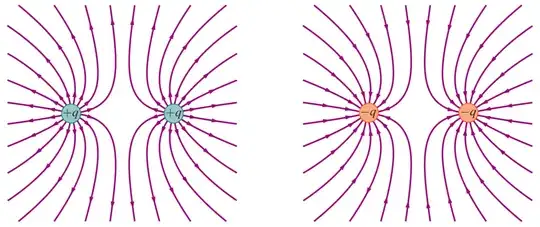

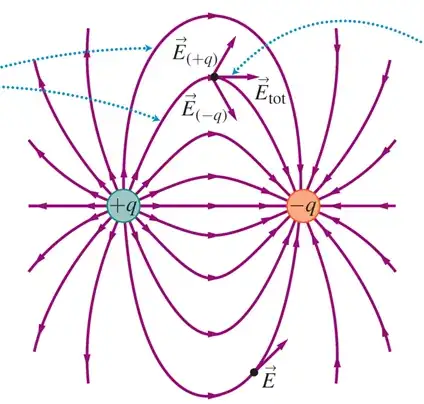

In a Physics textbook for students of a high school that does not introduce the flow of an electrostatic field and the subsequent concepts, there are some pictures of an electric dipole, a system formed by two equal and opposite charges, $+q$ and $-q$, separated by a non-zero distance. It is observed that if the algebraic sum of the charges is zero, and part of the lines of force extend to infinity and part, clearly, are the lines of force that start from the positive charge and close on the negative charge.
In the case of two positive and negative charges, the drawing that represented the lines of force is clear, but I observed that the algebraic sum of the charges is not zero.
Is there a rigorous mathematical proof of the reason that two charges of sign $+2q$ and $-q$, although not having algebraic sum zero, do not have field lines extending infinitely from charge $-q$ but the field lines are all closed relative to charge $-q$ starting from $+2q$? By drawing the electrostatic field with a test charge $+q_0$, the field lines are all close in $-q$.

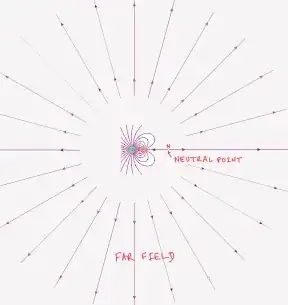

I cannot give you a rigorous mathematical proof but can give you an indication of what the electric field looks like far away from the charges.
The electric field would be practically indistinguishable from the the electric field due to a single charge $+q$.
The electric field lines would be radial and pointing outwards from the vicinity of the two charges.

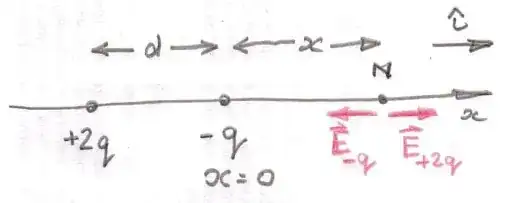

The electric field diagram is misleading it does not show that there is a neutral (zero field) point $(1+\sqrt 2)d$ to the right of the $-q$ charge. $d$ is the separation of the charges.
Beyond the neutral point the electric field line is pointing away from the charges (to the right).
To find where the neutral point, $N$, is consider the following diagram.
At the neutral point the electric fields due to the two charges are equal in magnitude and opposite in direction.
$\vec E_{\rm +2q} + \vec E_{\rm -q} = \vec 0 \Rightarrow k\dfrac {+2q}{(d+x)^2} \hat i + k\dfrac {-q}{x^2} \hat i = \vec 0 \Rightarrow \dfrac {2}{(d+x)^2} = \dfrac {1}{x^2} \Rightarrow x = (1+\sqrt 2)d$

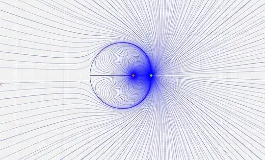

I have produced a better set of diagrams to illustrates the points that I have made in my answer. Note the charge of scale from diagram to diagram.

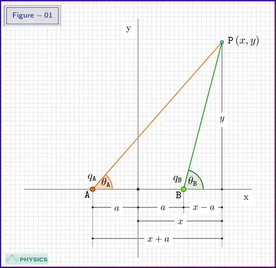

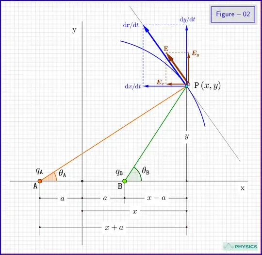

Two point electric charges $\:q_{\texttt A},q_{\texttt B}\:$ are standing still on the $\:\mr x\m$axis of a system $\:\mr{Oxyz}\:$ by a distance $\:2a\:$ apart, see Figure-01. By the presence of these charges we have a 3-dimensional electrostatic field at every point $\:\texttt P\plr{x,y,z}\:$ represented by the electric field intensity vector $\:\mb E\plr{x,y,z}$. An electric field line is a 3-dimensional curve with the vector $\:\mb E\plr{x,y,z}\:$ tangent to it at every one of its points. Because of the rotational symmetry around the $\:\mr x\m$axis the problem is 2-dimensional, so we will work on the problem in the plane $\:\mr{xy}$.
Suppose that an electric field line is a plane curve with regular parametric representation \begin{equation} \mb r\plr{t} \e \plr{\!\!\!\plr{x\plr{t},y\plr{t}\Vp{A^B_C}}\!\!\!} \tl{A-01} \end{equation} the variable $\:t\:$ being the parameter of the representation. A vector tangent to it at a point $\:\texttt P\plr{x,y}\:$ is \begin{equation} \dfrac{\mr d\mb r}{\mr dt}\e \plr{\dfrac{\mr dx}{\mr dt},\dfrac{\mr dy}{\mr dt}\Vp{A^B_C}} \tl{A-02} \end{equation} Since the electric field intensity vector $\:\mb E\plr{x,y}\e\plr{\!\!\!\plr{E_x\plr{x,y},E_y\plr{x,y}\Vp{A^B_C}}\!\!\!} $ is tangent to the curve at this point $\:\texttt P\plr{x,y}\:$ we must have, see Figure-02 \begin{equation} \dfrac{\mr dy/\mr dt}{\mr dx/\mr dt}\e\dfrac{E_y\plr{x,y}}{E_x\plr{x,y}} \tl{A-03} \end{equation} that is \begin{equation} \dfrac{\mr dy}{\mr dx} \e \dfrac{E_y\plr{x,y}}{E_x\plr{x,y}} \tl{A-04} \end{equation}
It was proved a posteriori that it would be difficult or may be impossible to succeed separation of the used variables $\:\plr{x,y}\:$ in order to have a solution of this differential equation. This equation was solved by an accidentally successful change of variables. The new variables are \begin{equation} u \e \tan\theta_{\mr A} \,,\qquad v \e \tan\theta_{\mr B}\qquad \text{with} \quad \theta_{\mr A},\theta_{\mr B}\bl\in \blr{0,2\pi} \tl{A-05} \end{equation} where $\:\plr{\theta_{\mr A},\theta_{\mr B}}\:$ the angles shown in Figure-01 or Figure-02. Using the geometry of the problem we'll transform the differential equation \eqref{A-04} with respect to $\:\plr{x,y}\:$ to a differential equation with respect to $\:\plr{ u, v}$. At first we have \begin{equation} \plr{x \m a}\tan\theta_{\mr B} \e y \e \plr{x \p a}\tan\theta_{\mr A} \nonumber \end{equation} or \begin{equation} \plr{x \m a} v \e y \e \plr{x \p a} u \tl{A-06} \end{equation} so \begin{equation} x \e \dfrac{\tan\theta_{\mr B}\p\tan\theta_{\mr A}}{\tan\theta_{\mr B}\m\tan\theta_{\mr A}}\, a \,,\qquad y \e \dfrac{2\tan\theta_{\mr B} \tan\theta_{\mr A}}{\tan\theta_{\mr B} \m \tan\theta_{\mr A}}\, a \tl{A-07} \end{equation} or \begin{equation} x \e \plr{\dfrac{v\p u}{v\m u}} a \,,\qquad y \e \plr{\dfrac{2\,v\, u}{v \m u}} a \tl{A-08} \end{equation} From \eqref{A-08} \begin{equation} \mr dx \e 2\,\dfrac{v\mr du\m u\mr d v}{\plr{v\m u}^2}\, a \,,\qquad \mr dy \e 2\,\dfrac{v^2\mr du\m u^2\mr d v}{\plr{v\m u}^2}\, a \tl{A-09} \end{equation} From \eqref{A-09} the left hand side of \eqref{A-04} is transformed as follows \begin{equation} \dfrac{\mr dy}{\mr dx} \e \dfrac{v^2\mr du\m u^2\mr d v}{v\mr du\m u\mr d v} \tl{A-10} \end{equation} For the transformation of the right hand side of \eqref{A-04} we have at first \begin{align} E_x & \e k\plr{q_{\mr A}\dfrac{x \p a}{\vlr{\mr{PA}}^3}\p q_{\mr B}\dfrac{x \m a}{\vlr{\mr{PB}}^3}} \tl{A-11a}\\ E_y & \e k\plr{q_{\mr A}\dfrac{y}{\,\vlr{\mr{PA}}^3}\p q_{\mr B}\dfrac{y}{\,\vlr{\mr{PB}}^3}\Vp{\dfrac{x \p a}{\mr{PA}^3}}} \tl{A-11b} \end{align} so \begin{equation} \dfrac{E_y}{E_x} \e \dfrac{\plr{\dfrac{q_{\mr A}}{\,\vlr{\mr{PA}}^3}\p \dfrac{q_{\mr B}}{\,\vlr{\mr{PB}}^3}\Vp{\dfrac{x \p a}{\mr{PA}^3}}}y}{\plr{\dfrac{q_{\mr A}}{\,\vlr{\mr{PA}}^3}\p \dfrac{q_{\mr B}}{\,\vlr{\mr{PB}}^3}\Vp{\dfrac{x \p a}{\mr{PA}^3}}}x\p \plr{\dfrac{q_{\mr A}}{\,\vlr{\mr{PA}}^3}\m \dfrac{q_{\mr B}}{\,\vlr{\mr{PB}}^3}\Vp{\dfrac{x \p a}{\mr{PA}^3}}}a} \tl{A-12} \end{equation} From the geometry of the problem \begin{equation} \vlr{\mr{PA}} \e \dfrac{y}{\sin\theta_{\mr A}} \,,\qquad \vlr{\mr{PB}} \e \dfrac{y}{\sin\theta_{\mr B}} \tl{A-13} \end{equation} and \eqref{A-12} yields \begin{equation} \dfrac{E_y}{E_x} \e \dfrac{\plr{q_{\mr A}\sin^3\theta_{\mr A} \p q_{\mr B}\sin^3\theta_{\mr B}}y}{\plr{q_{\mr A}\sin^3\theta_{\mr A} \p q_{\mr B}\sin^3\theta_{\mr B}}x \p \plr{q_{\mr A}\sin^3\theta_{\mr A} \m q_{\mr B}\sin^3\theta_{\mr B}}a} \tl{A-14} \end{equation} Replacing $\:x,y\:$ by their expressions \eqref{A-07} in terms of $\:\tan\theta_{\mr A},\tan\theta_{\mr B}\:$ we have \begin{equation} \dfrac{E_y}{E_x} \e \dfrac{q_{\mr A}\sin^3\theta_{\mr A} \p q_{\mr B}\sin^3\theta_{\mr B}}{ q_{\mr A}\sin^2\theta_{\mr A}\cos\theta_{\mr A}\p q_{\mr B}\sin^2\theta_{\mr B}\cos\theta_{\mr B}} \tl{A-15} \end{equation} Expressing the trigonometric functions $\:\sin\theta_{\mr A},\cos\theta_{\mr A}\:$ and $\:\sin\theta_{\mr B},\cos\theta_{\mr B}\:$ in terms of the new variables $\:\tan\theta_{\mr A} \e u\:$ and $\:\tan\theta_{\mr B} \e v\:$ respectively, that is \begin{align} \!\!\!\!\!\!\!\!\!\!\!\!\!\!\!\!\!\!\!\!\!\sin\theta_{\mr A} & \e \dfrac{\varepsilon_{\mr A}\tan\theta_{\mr A}}{\sqrt{1\p\tan^2\theta_{\mr A}}}\e \dfrac{\varepsilon_{\mr A}u}{\sqrt{1\p u^2}}\,, \quad \cos\theta_{\mr A} \e \dfrac{\varepsilon_{\mr A}}{\sqrt{1\p\tan^2\theta_{\mr A}}}\e \dfrac{\varepsilon_{\mr A}}{\sqrt{1\p u^2}} \tl{A-16a}\\ \!\!\!\!\!\!\!\!\!\!\!\!\!\!\!\!\!\!\!\!\!&\nonumber\\ \!\!\!\!\!\!\!\!\!\!\!\!\!\!\!\!\!\!\!\!\!\sin\theta_{\mr B} & \e \dfrac{\varepsilon_{\mr B}\tan\theta_{\mr B}}{\sqrt{1\p\tan^2\theta_{\mr B}}}\e \dfrac{\varepsilon_{\mr B}v}{\sqrt{1\p v^2}}\,, \quad \cos\theta_{\mr B} \e \dfrac{\varepsilon_{\mr B}}{\sqrt{1\p\tan^2\theta_{\mr B}}}\e \dfrac{\varepsilon_{\mr B}}{\sqrt{1\p v^2}} \tl{A-16b}\\ \!\!\!\!\!\!\!\!\!\!\!\!\!\!\!\!\!\!\!\!\!&\nonumber\\ \!\!\!\!\!\!\!\!\!\!\!\!\!\!\!\!\!\!\!\!\!\varepsilon_{\mr A} & \e \left. \begin{cases} \p 1, \quad \texttt{if } \theta_{\mr A}\bl\in \blr{0,\pi/2}\\ \m 1, \quad \texttt{if } \theta_{\mr A}\bl\in \blr{\pi/2, \pi} \end{cases} \right\}\,,\quad \varepsilon_{\mr B} \e \left. \begin{cases} \p 1, \quad \texttt{if } \theta_{\mr B}\bl\in \blr{0,\pi/2}\\ \m 1, \quad \texttt{if } \theta_{\mr B}\bl\in \blr{\pi/2, \pi} \end{cases} \right\} \tl{A-16c} \end{align} equation \eqref{A-15} yields \begin{equation} \dfrac{E_y}{E_x} \e \dfrac{\varepsilon_{\mr A}q_{\mr A}\plr{1\p v^2}^\frac32 u^3\p\varepsilon_{\mr B}q_{\mr B}\plr{1\p u^2}^\frac32 v^3}{\varepsilon_{\mr A}q_{\mr A}\plr{1\p v^2}^\frac32 u^2\p\varepsilon_{\mr B}q_{\mr B}\plr{1\p u^2}^\frac32 v^2} \tl{A-17} \end{equation} Combining \eqref{A-04}, \eqref{A-10} and \eqref{A-17} we have the differential equation in terms of the new variables $\:u,v$ \begin{equation} \dfrac{v^2\mr du\m u^2\mr d v}{v\mr du\m u\mr d v}\e\dfrac{\varepsilon_{\mr A}q_{\mr A}\plr{1\p v^2}^\frac32 u^3\p\varepsilon_{\mr B}q_{\mr B}\plr{1\p u^2}^\frac32 v^3}{\varepsilon_{\mr A}q_{\mr A}\plr{1\p v^2}^\frac32 u^2\p\varepsilon_{\mr B}q_{\mr B}\plr{1\p u^2}^\frac32 v^2} \tl{A-18} \end{equation} or \begin{equation} \varepsilon_{\mr A}q_{\mr A}\dfrac{u\,\mr du}{\plr{1\p u^2}^\frac32} \e \m\varepsilon_{\mr B}q_{\mr B}\dfrac{v\,\mr dv}{\plr{1\p v^2}^\frac32} \tl{A-19} \end{equation} that is \begin{equation} \varepsilon_{\mr A}q_{\mr A}\dfrac{\mr d\plr{1\p u^2}}{\plr{1\p u^2}^\frac32} \e \m\varepsilon_{\mr B}q_{\mr B}\dfrac{\mr d\plr{1\p v^2}}{\plr{1\p v^2}^\frac32} \tl{A-20} \end{equation} which integrated gives the solution \begin{equation} q_{\mr A}\dfrac{\varepsilon_{\mr A}}{\sqrt{1\p u^2}} \e \m q_{\mr B}\dfrac{\varepsilon_{\mr B}}{\sqrt{1\p v^2}}\p \texttt{constant} \tl{A-21} \end{equation} that is \begin{equation} q_{\mr A}\cos\theta_{\mr A} \p q_{\mr B}\cos\theta_{\mr B} \e \texttt{constant} \tl{A-22} \end{equation} We express this equation in the form \begin{equation} \boxed{\:\:\cos\theta_{\mr A} \p \lambda_q\cos\theta_{\mr B} \e \mr k \e \text{constant}\:\:\Vp{\tfrac{\dfrac{a}{b}}{\dfrac{a}{b}}}} \tl{A-23a} \end{equation} where \begin{equation} \boxed{\:\: \lambda_q \stackrel{\mr{def}}{\bl\equiv} \dfrac{q_{\mr B}}{q_{\mr A}}\e \text{ratio of the electric charges}\:\:\vp} \tl{A-23b} \end{equation}

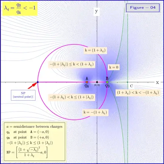

$\bl\S$ B. Two opposite point electric charges with unequal absolute values
This case corresponds to negative values of the ratio of charges, $\:\lambda_q\les 0\:$, except the value $\:\lambda_q \bl\ne \m 1\:$, that is
\begin{equation} \lambda_q \e \dfrac{q_{\mr B}}{q_{\mr A}} \bl\in \plr{\m\infty,\m 1} \bl\cup \plr{\m 1,0} \tl{B-01} \end{equation} The range $\:\plr{\m 1,0}\:$ in \eqref{B-01} could be omitted since a case with $\:\lambda_q \bl\in\plr{\m 1,0}\:$ would be considered as case $\:\lambda'_q \e \lambda^{\m 1}_q\bl\in\plr{\m\infty,\m 1}$. Also, for the case $\:\lambda_q \e \m 1\:$ we refer to $\bl\S$ C.

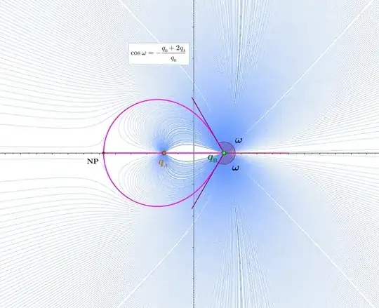

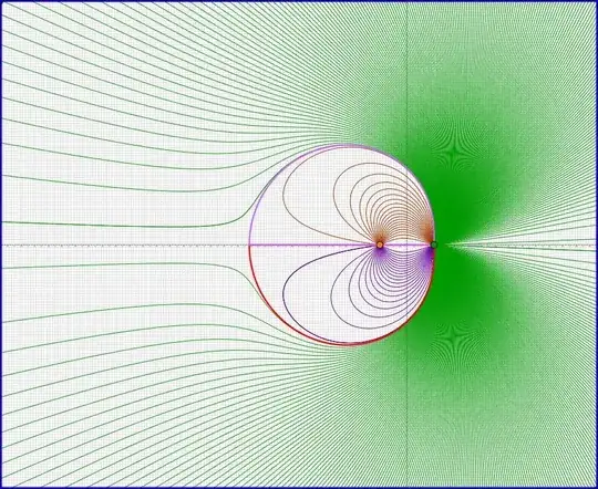

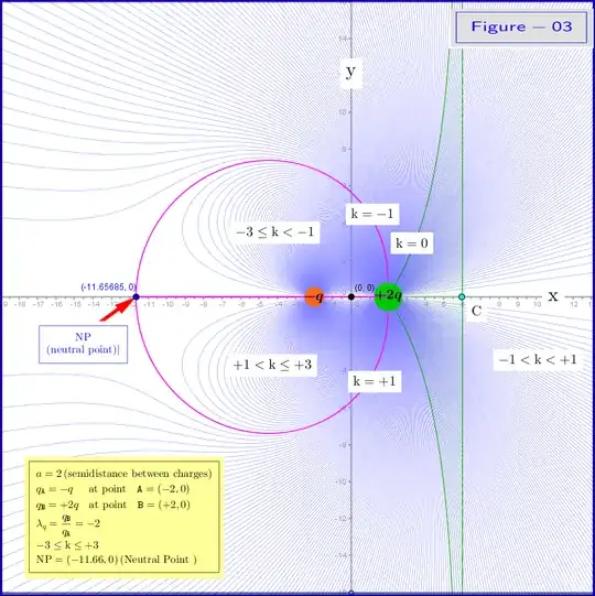

In Figure-03 we have a diagram of the electric field lines for the value $\:\lambda_q\e \m 2$. We'll explain point to point all about the details and numerical values. So according to \eqref{A-25} for the variable $\:\mr k\:$ we have
\begin{equation} \m 3\leseq\mr k\leseq \p 3 \tl{B-02} \end{equation} For these values the $\:\mr k\m$electric field lines are created as follows : \begin{equation} \nonumber \end{equation}
  1. $\:\plr{\m 3\leseq\mr k\les \m 1}\:$ Electric field lines joining the two charges in the upper half of the plane.
  2. $\:\plr{\mr k \e \m 1}\:$ Electric field line with semicircular-like part and straight segment part on the $\:\mr x\m$axis joining the two charges in the upper half of the plane. The semicircular-like part and the straight segment part on the $\:\mr x\m$axis meet at the neutral point $\:\mr{NP}\:$ where $\:\mb E \e \bl 0$. At the neutral point $\:\mr{NP}\:$ we have a discontinuity of the direction of the line tangent to the electric field curve.
  3. $\:\plr{\m 1\les\mr k\les\p 1}\:$ All electric field lines from the positive point charge $\:q_{\mr B}\e \p 2q\:$ to infinity. Especially for $\:\mr k\e 0\:$ the created electric field line moves away to infinity asymptotically to a straight line parallel to $\:\mr y\m$axis which intersects the $\:\mr x\m$axis at point $\:\mr C$. Although we have not a proof it seems that this point is the $^{\prime\prime}$$\textit{electric charge center}$ $^{\prime\prime}$. With reference to Figure-04 we must have \begin{equation} x_{\texttt C}\e\dfrac{q_{\texttt A}x_{\texttt A}\p q_{\texttt B}x_{\texttt B}}{q_{\texttt A}\p q_{\texttt B}} \tl{B-03} \end{equation} which applied to Figure-03 gives \begin{equation} x_{\texttt C}\e\dfrac{\plr{\m q}\plr{\m a}\p \plr{\p 2q}\plr{\p a}}{\plr{\m q}\p \plr{\p 2q}}\e 3\cdot a \e 3\cdot 2 \e 6 \tl{B-04} \end{equation}
  4. $\:\plr{\mr k \e \p 1}\:$ Electric field line with semicircular-like part and straight segment part on the $\:\mr x\m$axis joining the two charges in the loewer half of the plane. The semicircular-like part and the straight segment part on the $\:\mr x\m$axis meet at the neutral point $\:\mr{NP}\:$ where $\:\mb E \e \bl 0$. At the neutral point $\:\mr{NP}\:$ we have a discontinuity of the direction of the line tangent to the electric field curve.
  5. $\:\plr{\p 1\les\mr k\leseq \p 3}\:$ Electric field lines joining the two charges in the lower half of the plane. \begin{equation} \nonumber \end{equation}
Note that electric field lines joining the two charges are trapped inside the circular-like region (spherical-like in 3 dimensions) while the electric field lines from the positive point charge $\:q_{\mr B}\e \p 2q\:$ to infinity run outside of this circular-like region.
Figure-04 is identical to Figure-03 but with formulas on the basis of which the numerical values of the latter are derived.

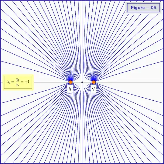

$\bl\S$ D. Two equal point electric charges
For this case, where $\:\lambda_q \e \p 1$, a typical diagram is shown in Figure-05.

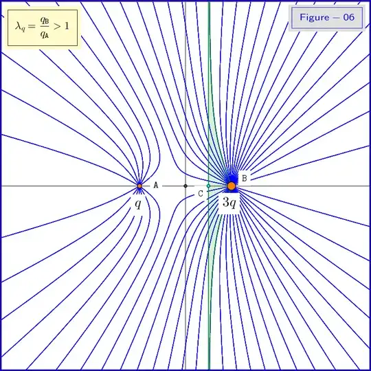

$\bl\S$ E. Two point electric charges of the same sign and unequal values
For this case, where $\:\lambda_q \gr\p 1$, a typical diagram is shown in Figure-06. Note that a field line from the absolutely larger charge moves away to infinity asymptotically to a straight line parallel to $\:\mr y\m$axis which intersects $\:\mr x\m$axis at point $\:\mr C$. It seems that this point is the $^{\prime\prime}$$\textit{electric charge center}$ $^{\prime\prime}$. With reference to Figure-06 we must have \begin{equation} \dfrac{\vlr{\texttt{CA}}}{\vlr{\texttt{CB}}} \e \dfrac{3q}{q}\e 3 \tl{E-01} \end{equation}

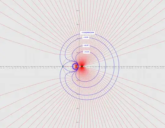

$\bl\S$ F. Equipotential lines (surfaces)
enter image description here Electric field lines versus equipotential surfaces (video).
$\bl{-\!\!\!-\!\!\!-\!\!\!-\!\!\!-\!\!\!-\!\!\!-\!\!\!-\!\!\!-\!\!\!-\!\!\!-\!\!\!-\!\!\!-\!\!\!-\!\!\!-\!\!\!-\!\!\!-\!\!\!-\!\!\!-\!\!\!-\!\!\!-\!\!\!-\!\!\!-\!\!\!-\!\!\!-\!\!\!-\!\!\!-\!\!\!-\!\!\!-\!\!\!-\!\!\!-\!\!\!-\!\!\!-\!\!\!-\!\!\!-\!\!\!-\!\!\!-\!\!\!-\!\!\!-\!\!\!-\!\!\!-\!\!\!-\!\!\!-\!\!\!-\!\!\!-\!\!\!-\!\!\!-\!\!\!-\!\!\!-\!\!\!-\!\!\!-\!\!\!-\!\!\!-\!\!\!-\!\!\!-\!\!\!-\!\!\!-\!\!\!-\!\!\!-\!\!\!-}$
Watch the production of this image here : Electric field lines of two unequal opposite charges (Video)
enter image description here Reference for above Figure : Angle of electrostatic field lines through an equilibrium point, see &Vincent Fraticelli's answer.

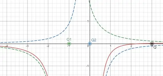

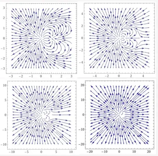

To add to the good answer by @Farcher,
  • Imagine walking along the x-axis from large positive-x to toward the negative charge $-q$ near the origin. You see what appears to be an "apparent point charge $+q$", so the electric field at your location is pointing radially away toward the positive-x direction, and seems to have an inverse-square dependence from the apparent point-charge.
  • Suppose instead, you were extremely close, just to the right of the negative charge. The electric field at your location would be directed toward the negative-x direction since the field at your location is dominated by the nearby negative charge $-q$.
  • Somewhere between large positive-x and just-to-the-right of the negative charge, the electric field must have been zero. In fact, as you approach from large positive-x, you begin to observe that the electric field is no longer inverse-square. You may be able to deduce that the "apparent point charge" is not a point charge... but a distribution of charges. At one point on the x-axis, you will find a location where the electric field is zero, due to the superposition of the electric fields of the $+2q$ charge and of the $-q$ charge, separated by a displacement $\vec d$. You can calculate this value of $x$, where $x>d$.
See my Desmos plot of the situation https://www.desmos.com/calculator/of7docjwsv
Note: the x-components of the electric force are being plotted (not the magnitude of the force).
(You can zoom in at the location of the target charge Q to see the behavior of the electric field near it.)
robphy-desmos-electric-force
