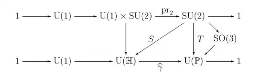

that is also made clearer by the following example 3.8 about $SO(3)$ and $SU(2)$. At first this didn't coincide with what I learned (i.e. that a proj. rep. of $SO(3)$ is isomorphic to an ord. rep. of $SU(2)$ and not of its central extension) but then in chapter 4 in the proof of Bargmann's theorem he proves that for a simply connected group, as an universal cover like $SU(2)$ naturally is, the exact sequence $$1 \rightarrow U(1) \rightarrow E \rightarrow SU(2) \rightarrow 1$$ splits and so we can avoid the passage to the central extension and have directly and ordinary rep. of $SU(2)$.

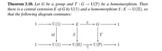

Now, to do so he uses theorem 3.10:enter image description here
I don't get why this couldn't apply directly to $S0(3)$ as the group $G$ instead of doing this:enter image description here

Schottenloher's chapter 3 and 4 are somewhat "non-linear" in that a lot of chapter 3 only makes sense after you've seen what chapter 4 does with it. In this particular case, sure, theorem 3.10 as written would apply to $G=\mathrm{SO}(3)$, and you would get some $E$ as a central extension. But this is a useless observation, because we don't have any machinery that would tell us something about this $E$! What you really want is that $E$ splits as $E\cong G\times \mathrm{U}(1)$ so that the lifting $S:E\to\mathrm{U}(\mathbb{H})$ reduces to a proper linear representation $S_2 : G\to\mathrm{U}(\mathbb{H})$.
Chapter 4 presents Bargmann's theorem as the main tool for this - the sequence splits for a $G$ that is simply-connected and has $H^2(\mathfrak{g},\mathbb{R}) = 0$. As the universal cover of $\mathrm{SO}(3)$, $\mathrm{SU}(2)$ is simply-connected and so Bargmann's theorem will apply to it, which is why Schottenloher is using it in this example.
You never need to worry about applying theorem 3.10 to groups that aren't simply connected: Every projective representation of a group lifts to a projective representation of its universal cover and in fact all projective representations of the cover are also projective representations of $G$ because the universal cover is just a central extension by the fundamental group $\pi_1(G)$, so we can always apply this theorem to the universal cover to have a chance of applying Bargmann's theorem afterwards.
