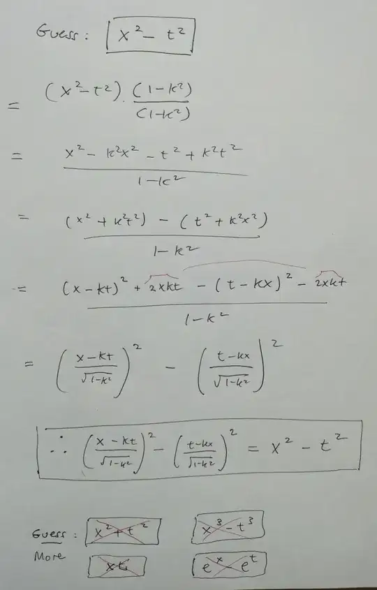

What are the methods for guessing the invariant quantity:
$$x^2 - t^2$$
under Lorentz transformation
$$x'=\gamma(x-vt)$$ $$t'=\gamma\left(t - {vx}\right)$$
where c = 1.

The invariance can be generated by a clever algebraic term exchange between x and t during transformation. From this backward:
Because - signs are required at different times to properly balance the term exchange, intuitively other quantities having only + terms or odd powers are not likely to work as invariants.
James
  • 637
