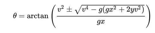

I'm given initial speed, distance and gravity. I know that theta is:
Formula for launch angles
Where $v$ is the initial velocity, $x$ the distance and $y$ the initial height.

What you're doing is modeling an object with "linear drag". Since the rate at which the velocity decreases is proportional to the velocity itself, we can write $$ \frac{\Delta v_x}{\Delta t} = - \frac{0.025 v_x}{25 \text{ ms}} = - \alpha v_x $$ (more or less), with $\alpha = 10 \text{ s}^{-1}$. A similar equation holds for $v_y$, but with the gravitational acceleration of $-g$ factored in.
Since the drag is linear, it is possible to solve exactly for the position and the velocity as a function of time; I did so in my answer here. However, finding a "range equation" is a much harder; you would have to find the time $t$ of the landing of the object and then figure out the value of $x$ at that time, which I don't think is actually doable algebraically (since $y(t)$ is transcendental in $t$.) Trying to find a nice function for $\theta$ as a function of the desired range is probably a fool's errand.
The best tactic would be to solve the problem iteratively, just like the artillery officers do in the real world: generate a trajectory, see where it lands, adjust the angle accordingly, and repeat until the answer is "close enough".
