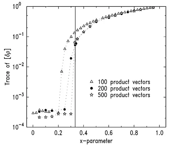

In the literature a most significant contribution came from Lewenstein and Sanpera in 1998 with a Letter proving that for any density matrix $\rho$ and set $V$ of product vectors belonging to the range (i.e. rowspace) of $\rho$ there exists a best separable approximation (BSA) of the matrix in the sense $\rho=\rho_s^*+ \delta \rho$ where $\rho_s^*$ is separable and the trace $\text{Tr}\delta \rho$ of the entangled part is minimised.
They also provided an explicit construction for the separable part. The idea is to generate a large set $V$ of projectors $\lvert \alpha \rangle \langle \alpha \rvert$ randomly chosen from $\text{Range}(\rho)$ and seek a decomposition $\rho_s^*=\sum_{\alpha\in V} \Lambda_\alpha \lvert \alpha \rangle \langle \alpha \rvert$ where the $\Lambda_\alpha \geq 0$ are pairwise maximised: $(\Lambda_{\alpha_1} \lvert \alpha_1 \rangle \langle \alpha_1 \rvert + \Lambda_{\alpha_2} \lvert \alpha_2 \rangle \langle \alpha_2 \rvert) $ should be the largest contribution that can subtracted from $\rho$ whilst retaining the non-negativity of the difference $(\dagger)$.
Lewenstein and Sanpera include explicit expressions for the $\Lambda_\alpha$, but in practice resort to trial-and-error (i.e. brute force) to sidestep potential issues of convergence here. Below is the one figure from their Letter showing the trace of the residual (non-separable) part when applying this approach to a $2\otimes2$ Werner state $\rho_w(x)$ known to be separable for values of the parameter $x\leq 1/3$. The upshot is that, provided the number of product vectors chosen for $V$ is sufficiently large, the result does not depend on this number and the true BSA is obtained (the non-zero part seen for $x\leq 1/3$ is a result of the numerical precision set to $10^{-4}$ here).
Phys. Rev. Lett. 80, 2261 ©1998 American Physical Society
