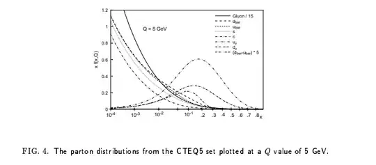

BUT you are not aware that in field theories the particles shown in the proton are virtual. . Virtual means that in the mathematics of the theory the mass of each depicted as quark anti quark gluon is off mass shell, it does not exist outside the nucleus. Only the accumulation of scattering events on the protons , in the first image, can be predicted by the field theory mathematics, and the fits have given rise to the parton model of the nucleus.
See some parton distribution functions
parton
If you go to the link you will be able to enlarge and see the individual plots for quarks etc.
So the infinity is a mathematical infinity, and for each individual scatter what is important are the conservation laws as Rob describes.
