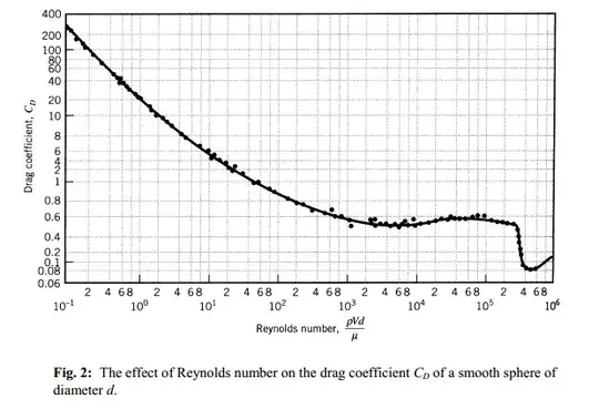

$C_d$ is a function of speed via the Reynolds number. See here and here.
For some numeric values for the $C_d$ vs. $\rm Re$ use the following from here of which you take the log values to interpolate.

The kinematic viscosity of Air is $\nu = 14.8\; \rm{cSt} = 14.8 \cdot 10^{−6}\; \rm{m^2/s}$. At a speed of $v=20\;\rm{m/s}$ a ball with diameter $d=5\,\rm{cm} = 0.05\;\rm{m}$ has Reynolds number of $\rm{Re} = \frac{v d}{\nu} = 67400 $.
When you look at the $C_d$ vs. $\rm Re$ graph you get $C_d = 0.47$. The area of the ball is $A=\pi \frac{d^2}{4} = 0.001964\;\rm{m^2}$ so the drag force is
$F_d = \frac{1}{2} \rho A C_d v^2 = \frac{1}{2} (1.2\;\rm{kg/m^3}) (0.001964\;\rm{m^2}) (0.47) (20\;\rm{m/s})^2 = 0.2215\;\rm{N}$

According to this Wikipedia article, the drag coefficient for a shpere is $0.47 $.
