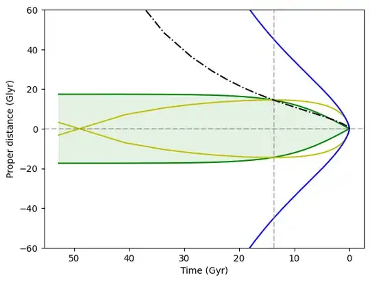

I am trying to replicate the space time plot (the 2nd plot with Proper distance vs Time) as in this thread:A Cosmological horizon at the Hubble radius?
I wrote everything in python using the astropy cosmology package. Everything went smooth, but I am stuck at plotting the light path on the 'purple path', as per the example in the link. I don't know how to plot the light path for the light emitted by the galaxy at t0 = 0 (now), with the proper distance of aprox 13.8 Glyr, that will reach us a t=49 Gyr. Here is the code in python:

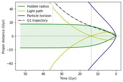

The resulting plot:
space-time
With @benrg help, the plot works as expected:
Adrian
  • 143
cosmo.comoving_distance gives you the $(z,r(z))$ coordinates of a null geodesic that passes through $(0,0)$. By homogeneity, $(z,r_0+r(z))$ is also a null geodesic for any $r_0$. You want $r_0\, a(z{=}0) \approx 13.8\text{ Glyr}$.
