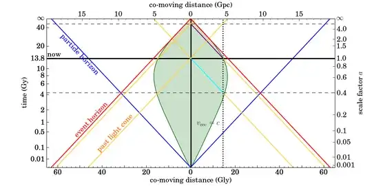

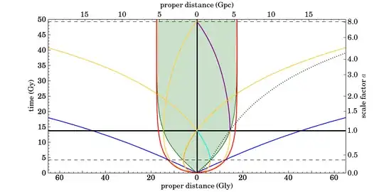

The situation is displayed in these graphs (click on 'view image' for a larger version): the first is with co-moving coordinates, the second with proper coordinates.
The black solid lines indicate our present position. The blue line is the particle horizon through time, the red line is the event horizon, the green area is the Hubble sphere. The dotted black line is a co-moving galaxy that is currently located on the Hubble radius. Its photons that we observe today have travelled on the cyan path (they were emitted at $t=4.3\;\text{Gy}$). Its photons that it emits today ($t=13.8\;\text{Gy}$) will travel on the purple path (they will reach us at $t=49\;\text{Gy}$).

Looking once more time at the graph (presented by Pulsar), You see that, at present time, this Hubble distance (corresponding to green line $v_{rec} = c$) is smaller than the present event horizon ($\sim 16$ billion light-year), so any light ray emitted from the extremity of the ruler, at present time, will always reach the origin of the ruler in the future.
In fact, at all times, the Hubble distance is smaller than the event horizon.
You see, in the graph, that the redshift can be read directly, at the intersection of the green line $v_{rec} = c$, and the horizontal black line, the redshift (dashed purple line) is between $z=1$ and $z=3$
