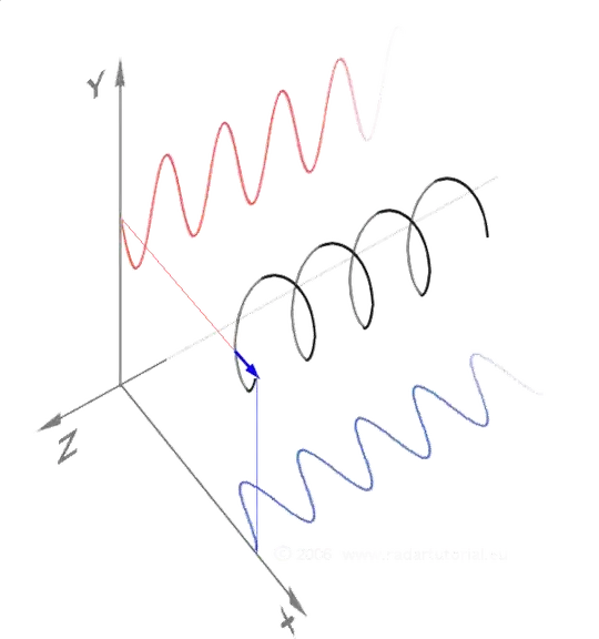

I’ve read that linear polarization is horizontal or vertical, but can’t it be at any angle?
Yes, it can be at any angle. There are also elliptical polarizations, which are intermediate between linear and circular, and can also be tilted at any angle.
What your sources may have been saying is that from sums of two polarization directions, such as horizontal and vertical, you can construct any polarization direction. If you add them in equal amounts with the same phase (so they reach zero at the same time), you get 45° diagonal polarization. If you add them out of phase by the right amount, you get circular polarization:
and if you add them out of phase by a different amount, you get an elliptical polarization.

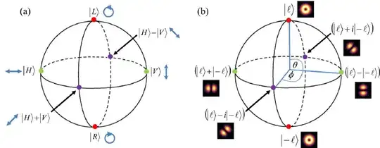

Now once you have a two state system, all possible pure (mixed) states can be described as by point on (in) the Bloch Sphere. It could be a two level atomic system, or a spin 1/2 particle, or photon polarization. They all have the same allowed mathematical mixtures, it's just that the physical interpretation depends on the underlying system.
For example, for the spin 1/2 particle, and pure superposition of up and down lies on the Block sphere, and represents a spin eigenstate along a different axis.
Meanwhile, transverse polarizations of the photon are not possible, and the superpositions of $|R\rangle$ and $|L\rangle$ do not allow a spin pointing in any direction. Rather, see the left figure:
The poles are the helicity eigenstates. Note that the states on the equator, such as:
$$ |H\rangle = \frac 1 {\sqrt 2}\big(|R\rangle +|L\rangle \big)$$ $$ |V\rangle = \frac 1 {\sqrt 2}\big(|R\rangle -|L\rangle \big)$$
are linearly polarized (Here, horizontal and vertical...which are orthogonal).
Now the astute reader will note that $|H\rangle$ and $|V\rangle$ are 180 degree apart, while (anti)diagonal polarizations, are at 90 degrees relative to $|H\rangle$ and $|V\rangle$. Aren't we missing 180 degrees of support?
No.
Linear polarization is a tensor polarization. It does not define an axis, it defines an alignment, which is a line without a preferred direction, and that requires 180 degrees of support to cover all directions, err, alignments.
Now you don't need two photons to make linear polarization, but it is the superposition of two circular basis states. Nevertheless, the basis is arbitrary, as long as it is made of 2 antipodal points on the Bloch sphere, it's orthonormal and complete.
Finally, all the allowed complex linear combinations of the basis states make up circular, linear and elliptical polarizations, lying on the surface of the sphere.
Inside the sphere are mixed states (e.g., density matrices), with the center being totally unpolarized.
Finally: note that the Bloch sphere for light polarization is called the Poincare sphere.
