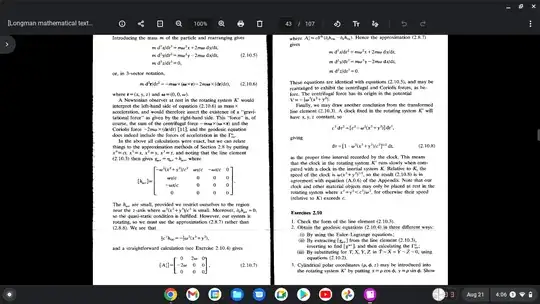

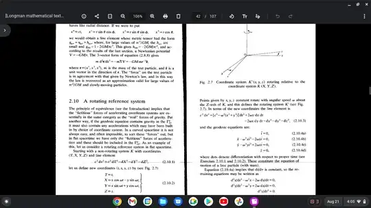

For details see A Short Course in General Relativity. Nightingale & Foster. Page 64. Longman, 1979. (This is an early edition. The later editions of this book are not as good.)
