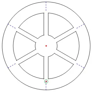

Yes there is time dilation compared to the lab frame for a rotating body around a point inside the lab space at distance $r$ with the Lorentz equation you are given and not only that but also for a hypothetical observer on the surface of an object for ease say, a sphere spinning around its diameter axis and of $r$ radius.
Using the parallel axis theorem the observer on a point on the surface of the fast spinning sphere with a tangential velocity of $υ=ωr$ will experience time dilation relative to the lab's inertial frame of reference the same as he would if translating in a straight path through space with the same speed $υ$ thus both cases are equivalent in SR since SR time dilation is depending only at the speed thus the scalar value of the velocity vector.
However, there is an important condition for the above time dilation to be true. The stationary observer on the lab frame must be outside the volume area of rotation:
rotational time dilation
By P. Fraundorf - Own work, CC BY-SA 4.0, https://commons.wikimedia.org/w/index.php?curid=51215249
So, as shown in this animation the stationary observer red dot at the center and the bouncing red dot rotating observer are actually both in the same rotating absolute frame of reference. In this case no time dilation is observed. In order time dilation to be experienced the observer at the center must move out of the rotating frame inside the lab inertial frame.
