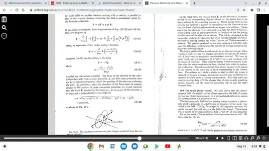

The section on the "virtual photon" is in chapter 18. Section 3 "The Virtual Photon Concept"
Classical Electricity And Magnetism, 1929

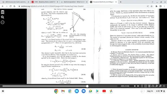

The energy of the electromagnetic wave is (in terms of its Fourier components) is calculated.
$$U= \int_0^\infty U_\omega\mathrm d\omega$$
$$U_\omega =\frac{2}{\pi} \frac{e^2}{4\pi \epsilon_0 u} \ln\left(\frac{\gamma u}{\omega b_{min}}\right),$$ where $u$ is the velocity.
The number of "equivalent photons" $N_\omega$ is defined by $U_\omega\mathrm d\omega = \hbar \omega N_\omega\mathrm d\omega$ such that $$N_\omega\mathrm d\omega = \frac{2\alpha}{\pi} \ln(E/A\hbar\omega) \frac{\mathrm d\omega}{\omega}$$
and
$$N_\omega\mathrm = \frac{2\alpha}{\pi} \ln(E/A\hbar\omega) \frac{\mathrm 1}{\omega}.$$
$\alpha$ is the fine structure constant, $A$ is a numerical constant and $E$ is the energy of the particle.
Hence the spectrum of “equivalent photons” varies approximately as $l/\omega$. The number of equivalent photons per electron is small, namely, of the order of 1/137. Equation (18-38) is very useful in relating the probability of processes induced by electrons, or by other particles which act essentially only through their electromagnetic field, to the probability of processes induced by electromagnetic radiation.
