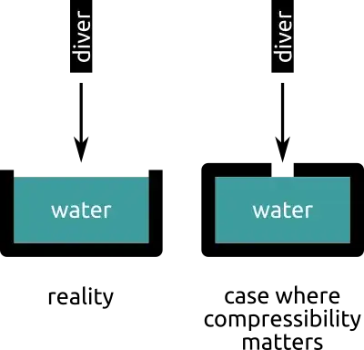

Adding another perspective to the existing answers:
In your usual diving scenario, water is not confined to the points in space it occupied before, while a slab of ground is – on account of water being liquid and ground being solid.
To construct a scenario where you primarily experience the compressibility when diving into water, you would have to exactly encase the body of water with a perfectly rigid wall with only an exactly diver-shaped hole in it – through which the diver needs to enter. (Also, your diver would have to have the same cross-section everywhere along the direction of diving.) In that case, the water cannot escape to the sides anymore and the diver would fully feel that water is incompressible: They would not be able to enter the water at all and crash into it like a wall.
Illustration of the described scenario
