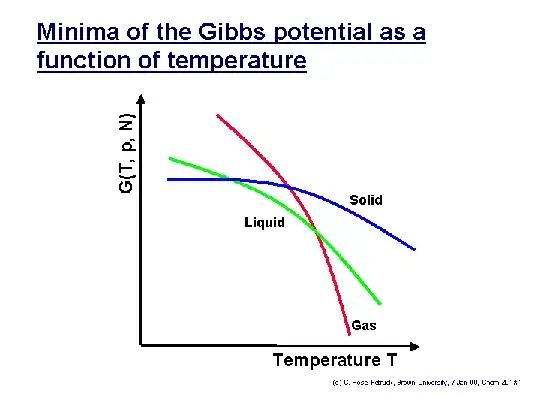

A phase transition temperatures is simply the intersection in the Gibbs free energy (or the chemical potential, which is just the molar Gibbs free energy) of two phases:
The Gibbs free energy $G$ incorporates the enthalpy $H$, temperature $T$, and entropy $S$ as $G\equiv H-TS$, so we find that the temperature-dependent slope of every curve is that phase's entropy. (Observe that high-entropy gas always has a steeper curve than low-entropy condensed matter.) The lower $G$ curve is the more stable one. Accordingly, we see solids melt into liquids and then boil into gases as the temperature increases.
Regelation occurs because applying a pressure to a region of solid ice increases its Gibbs free energy as $G=F+PV$, where $F$ is the Helmholtz free energy, $P$ is pressure, and $V$ is volume. Pushing the blue curve up in the diagram clearly lowers the equilibrium temperature with liquid water. (The green curve doesn't move because the liquid, being a fluid, can simply move away from a region of local compression; thus, the Gibbs free energy of the liquid remains unchanged.)
