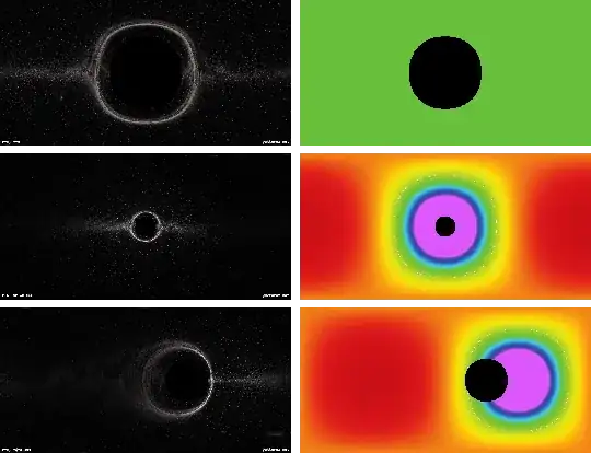

If you move towards it the shadow looks smaller, and if you move away from it bigger, due to the aberration. If you do the raytracing in the stationary frame you can apply the special relativistic doppler with the velocity relative to a local stationary observer, see here, or here where three observers at the same location, but with different velocities relative to the BH compare their views with $360°\times180°$ full panoramas:
black hole viewed with different velocities
In the upper images the observer is at rest, in the middle moving radially towards the BH and at the bottom flying past it to the right, in the transverse direction (using this color code for the red/blueshift).
All three observers are at the same Schwarzschild coordinate $\rm r=\rm 3 \ r_s=6 \ G M/c^2$. In the frame without the accretion disc the naked shadow of the Schwarzschild BH looks perfectly round for all observers.
