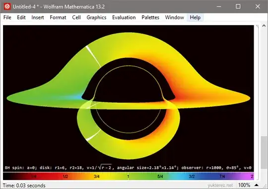

First you get the ratio of the gravitational time dilation between observer and emitter. Then you check the light ray's vector at emission and see how much of it was in direction of motion so you multiply the resulting special relativistic Doppler. The result should look like this:
Schwarzschild disc doppler raytracing
The image above is in the frame of a stationary observer at r=1000GM/c², θ=85°. If the observer is moving (see here for an example with different directions of motion) as well just apply the special relativistic aberration for his local velocity relative to a stationary reference observer (see here for an example how it's done).
