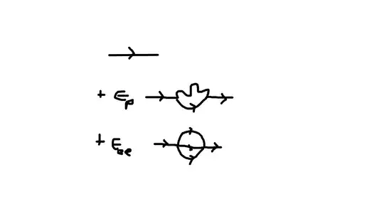

Think about the exact (i.e. interacting) electron propagator $\mathcal{G}(x,x') = -i \langle0|T \psi_\alpha(x) \bar{\psi}_\beta(x') |0 \rangle$. If interactions are weak (i.e. in the perturbative regime), you can expand this as a series in powers of the coupling constant - to second order it is the noninteracting propagator, with some loop corrections from phonons and electron-electron $a^\dagger a a^\dagger a$ type vertices e.g.enter image description here
The point is that these terms will phase shift the electron relative to the noninteracting theory, which is one interpretation of "decoherence". The full state of the system is not experimentally observable at one time - if you consider taking a partial trace over all of the many-body degrees of freedom, the effect of these terms is (generally) a summed random phase that gets worse over time, leading to ideas of coherence length and coherence time.
