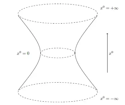

where $\alpha^{a}$ is a vector of infinitesimal measure ($\alpha ^{2} \approx 0$) and $T^{a}$ are the generators of the algebra. This is how one associates Lie groups to their respective Lie algebras. The Lorentz group for our case that is generated by matrices abiding by the aforementioned Lorentz group Lie algebra, when embedded in 5-dimensional Minkowski space it is going to be a 4-dimensional hyperboloid:
(You may ignore the coordinate tags, I used a Latex graph of mine used in another context).
