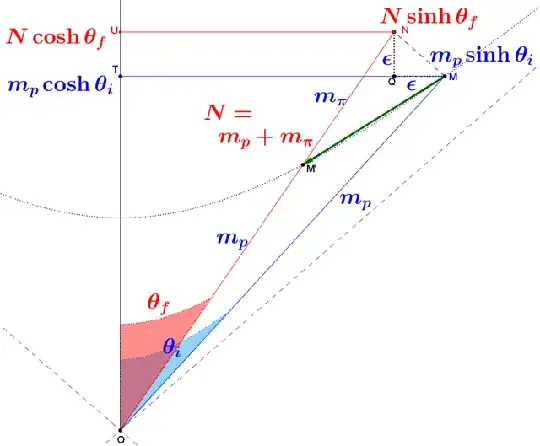

The conservation of total-4-momenta can be drawn as a polygon on an energy-momentum diagram (with energy running upward). \begin{align} \tilde {\bf p_1} + \tilde{\bf \gamma} &= \tilde {\bf p_2} + \tilde{\bf q}\\ \tilde {\bf OM} + \tilde{\bf MN} &= \tilde {\bf OM'} + \tilde{\bf M'N}\\ \end{align}
The OP is looking for the lab-frame's energy-component of the change in the 4-momentum of the proton, $\tilde{\bf MM'}$, which is a spacelike chord on the mass-shell of the proton.
The "threshold condition" means that the outgoing particles are at rest with respect to each other. Vectorially, this means $\tilde {\bf p_2} =f \tilde{\bf q}$ (their 4-momenta are parallel), where $f=m_p/m_{\pi}$, the ratio of their rest-masses. Geometrically, this means "$O$, $M'$, and $N$ are collinear", and thus the polygon that would have been a quadrilateral reduces to a triangle in this case. Furthermore, this means that the "invariant mass" of the system is equal to the sum of the rest-masses of the outgoing particles: $N=m_p+m_{\pi}$.
In the spirit of the Bondi k-calculus, since $\tilde{\bf\gamma} =\tilde{\bf MN}$ is future-lightlike and $\tilde{\bf OM}$ and $\tilde{\bf ON}$ are future-timelike, we can immediately write \begin{equation}N=\exp(\theta_i -\theta_f) m_p,\end{equation} where $\exp(\theta_i -\theta_f)$ is the reciprocal of $k_{rel}=\exp(\theta_f -\theta_i)$, the relative-Doppler factor written in terms of the relative-rapidity. In my opinion, the beauty of this is that $$k_{rel}=\exp\theta_{rel}=\frac{1}{\exp(\theta_i-\theta_f)}=\frac{m_p}{N}=\frac{m_p}{m_p+m_{\pi}}$$ Since $k=\sqrt{\frac{1+v}{1-v}}$, we have $v=\frac{k^2-1}{k^2+1}$. So, $k_{rel}<1$ implies $v_{rel}<0$--that is, the final particle is slower.
In hindsight, it is interesting to note that $$k_{rel}-1= \left(-\frac{m_{\pi}}{m_p+m_{\pi}}\right).$$

\begin{align} \frac{\Delta E}{E}=\frac{(MM')_t}{(OM)_t} &=\frac{\epsilon-m_{\pi}\cosh\theta_f}{m_p\cosh\theta_i} &=\frac{\epsilon-m_{\pi}\cosh(\theta_i+\theta_{rel})}{m_p\cosh\theta_i} \end{align} is the exact result, but is likely rather messy to proceed. And we might need information about $\theta_i$ (about the initial proton velocity in the lab frame).
  • (UPDATE) Here is a slightly different way to proceed before making an approximation, as was done in the ORIGINAL section.
    \begin{align} \frac{\Delta E}{E} &=\frac{\epsilon-m_{\pi}\cosh(\theta_i+\theta_{rel})}{m_p\cosh\theta_i}\\ &=\frac{\epsilon}{m_p\cosh\theta_i} -\frac{m_{\pi}}{m_p} \left(\frac{\cosh\theta_i \cosh\theta_{rel}+\sinh\theta_i \sinh\theta_{rel}}{\cosh\theta_i}\right)\\ &=\frac{\epsilon}{m_p\cosh\theta_i} -\frac{m_{\pi}}{m_p} \left(\cosh\theta_{rel}+\tanh\theta_i \sinh\theta_{rel} \right) \end{align} Now invoke the ultra-relativistic condition so that $\tanh\theta_i \approx 1$ and use the identity $\exp\theta=\cosh\theta+\sinh\theta$ to get \begin{align} \frac{\Delta E}{E} &\approx\frac{\epsilon}{m_p\cosh\theta_i} -\frac{m_{\pi}}{m_p} \exp\theta_{rel} \end{align}
  • (ORIGINAL) However, if we now invoke the ultra-relativistic condition, then $\theta_i, \theta_f \gg 1$,
    which implies that $\exp\theta\gg 1$ and thus $\exp\theta \approx 2\cosh\theta$. \begin{align} \frac{\Delta E}{E}\approx \frac{\epsilon-m_{\pi}2\exp(\theta_i+\theta_{rel})}{m_p 2\exp\theta_i} &= \frac{\frac{1}{2}\epsilon\exp(-\theta_i)-m_{\pi}\exp(\theta_{rel})}{m_p} \end{align}
Using the condition that $\epsilon\exp(-\theta_i) \ll m_{\pi}$ (either small $\epsilon/m_{\pi}$, initially ultra-relativistic proton, or both), we further approximate as \begin{align} \frac{\Delta E}{E}\approx \frac{-m_{\pi}\exp(\theta_{rel})}{m_p} =\frac{-m_{\pi}\left( \frac{m_p}{m_p+m_{\pi}} \right)}{m_p} \stackrel{\checkmark}{=}\frac{-m_{\pi}}{m_p+m_{\pi}}. \end{align} (Maybe $k_{rel}-1$ can be shown to naturally here, together with a physical interpretation.)
