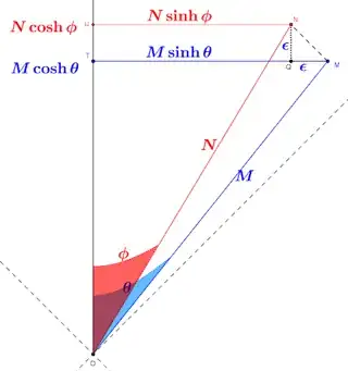

robphy-spacetimetrig
I'm going to use rapidity $\theta$, where $v=\tanh\theta$ and thus
the Lorentz factor $\Gamma=\cosh\theta$ and $v\Gamma =\sinh\theta$ and the Doppler factor $k=\exp\theta$.
Using components in the lab frame, energy-momentum conservation yields \begin{align} N\cosh\phi &=M\cosh\theta+\epsilon\\ N\sinh\phi &=M\sinh\theta-\epsilon \end{align} By addition, we obtain $$\boxed{ \begin{align} N\exp\phi &=M\exp\theta, \end{align} } $$ which is essentially the Doppler Effect, where $K=\exp(\theta-\phi)=(N/M)$ is relative-Bondi-Doppler factor.
By subtraction, we obtain $$ \boxed{\begin{align} N\exp(-\phi) &=M\exp(-\theta)+2\epsilon, \end{align}} $$ [The above boxed equations represent
"energy-momentum conservation in light-cone coordinates" (in the eigenspace)]
We wish to eliminate $N$ (the mass of the final particle resulting from the absorption of the photon)
By multiplication, $$\boxed{N^2=M^2+2\epsilon M\exp\theta}$$ which is the related to Alex's $\Rightarrow$ equation, but without using any approximation.
(Of course, this is the square-norm of the 4-momentum equation $\tilde N=\tilde M+\tilde \gamma$.)
Re-write this as \begin{align} \left(\frac{N}{M}\right)^2 &=1+\frac{2\epsilon}{M}\exp\theta \\ K^2 &=1+\frac{2\epsilon}{M}\exp\theta \\ (\exp(\theta-\phi))^2 &=1+\frac{2\epsilon}{M}\exp\theta \\ \end{align}
(This is the a-ha moment!) Taking square-roots, \begin{align} \exp(\theta-\phi) &=\sqrt{1+\frac{2\epsilon}{M}\exp\theta} \\ \end{align} and solving for $\exp\phi$, we have \begin{align} \exp\phi &=\frac{\exp{\theta}}{\sqrt{1+\frac{2\epsilon}{M}\exp\theta}} \\ \end{align} This is a physics relationship between the lab frame's Doppler factors of the initial and final particle, the mass $M$ of initial particle and the photon energy $\epsilon$ in the lab frame. That is, $$ \boxed{\boxed{ \begin{align} k_N &=\frac{k_M}{\sqrt{1+\frac{2\epsilon}{M}k_M}} \\ \end{align} }} $$ which is an exact result.

The double-boxed result is obtained more directly by division of the first pair of boxed equations, rather than multiplication then some additional algebra to eliminate $N$.
\begin{align} \boxed{\exp(2\phi) = \frac{M\exp\theta}{M\exp(-\theta)+2\epsilon}} &= \frac{\exp(2\theta)}{1+\frac{2\epsilon}{M}\exp\theta}\\ \exp\phi &= \frac{\exp\theta}{\sqrt{1+\frac{2\epsilon}{M}\exp\theta}}, \end{align} which is the double-boxed equation (when the Doppler-$k$ is introduced)!
