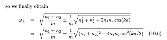

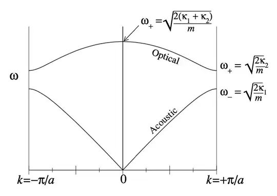

Since $\omega$ is a parameter in the dispersion relation $E(k)$, with two values of $\omega$ we obtain two dispersion relations, corresponding to two normal modes in Brillouin zone scheme. (Note that from the figure below we see when $\kappa_1 - \kappa_2 \to 0$, the two curves will be connected; in extended BZ scheme, the two curves will be one, and the 1st and 2nd BZ could be combined, and the model will converges to the monoatomic chain model.)

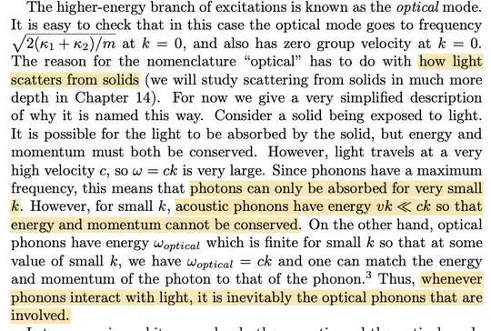

Q2: Why the two modes are called accoustic/optical modes?
(I am still confused by the author's energy/momentum conservation explanation of accoustic/optical modes.)
Generally the definition of an acoustic mode is any mode that has linear dispersion as k → 0.
a4
(the author seems to say that because when light interact with phonons, due to momentum and energy conservation, only phonons with higher energy/momentum could be involved. Phonons in accoustic modes have small $k$ in BZ nearest to 0. So only phonons in other modes would be involved and therefore called 'optical'.
(this seems to be relevant to (in)direct band and why when photons require phonons to transit from valence band to conduction band such transition can hardly happen (as discussed here). )

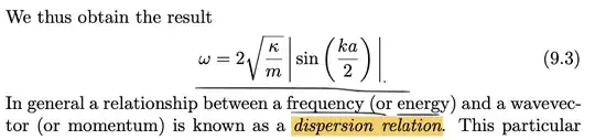

In 1d monoatomic chain, we calculate $E(k)$ using an differential equation (named Newton’s equation of motion) involving the frequency $\omega$, and an ansatz too.
b1..b2..b3 Since $E$ is proportional to the frequency $\omega$, we get the $E(k)$ directly from $\omega$ (as a function of $k$). (Correction: $\omega$ is not a parameter in the function $E(k)$)

Physically, in the acoustic modes adjacent different-mass atoms move in the same direction while in the optical modes they move in opposite directions.
