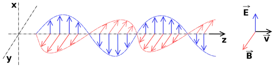

The simplest EM wave will have one oscillating E field and one oscillating B (magnetic) field. That wave will be polarized (i.e. E field is wiggling in one specific direction) and monochromatic (i.e. perfect sine wave).
From Wikepedia entry on EM Radiation

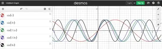

Here's an example of what I'm talking about plotted in desmos. This is a bunch of waves. Each is polarized in the same direction (i.e. up and down). Each has a different frequency.
Made by me using Desmos

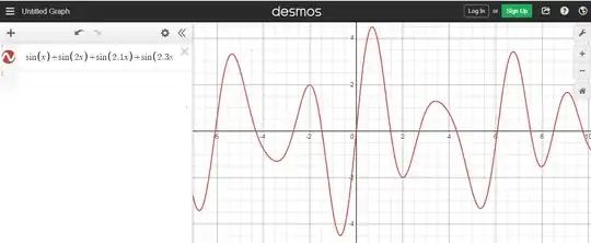

Here's what the actual wave would look like (because the total E field at any given location comes from the SUM of all your separate individual E fields)
From Desmos

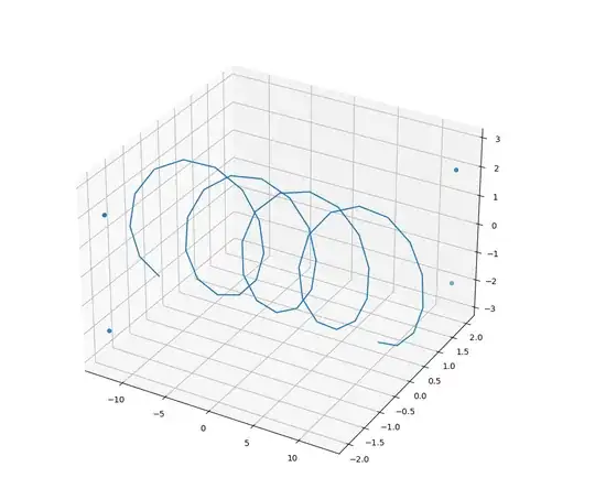

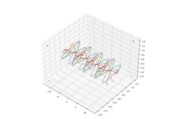

Here's an example of a lot of simple EM waves of different polarizations being added together. (Made in python)
These are all the simple sine waves considered separately. enter image description here
And this would be the scalar E field you'd get when they're all added together. enter image description here
