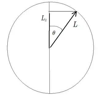

In quantum mechanics angular momentum is quantized like this: $$L^2=\ell(\ell+1)\hbar^2$$ $$L_z=m_\ell\hbar$$
Semiclassically the angle $\theta$ between $\vec{L}$ and the $z$-axis is given by $$\cos\theta=\frac{L_z}{L} =\frac{m_\ell}{\sqrt{\ell(\ell+1)}}\approx\frac{m_\ell}{\ell}$$
This means, when $\ell$ is large, then this angle $\theta$ can change in very small steps. And for $\ell\to\infty$ the angle can take every real value between $0°$ and $180°$.
