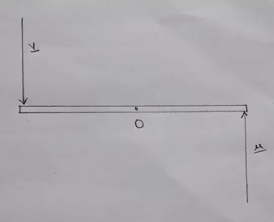

Scenario 2:
Here, $O$ is the center of mass of a rigid and uniform bar. None of the points on the bar are affixed: it is an unconstrained bar. Here, $|\underline{u}|=|\underline{v}|$. Due to the couple, the bar will rotate about its center of mass. If there's rotation, there must be a centripetal force. What is the centripetal force in this scenario and how can I calculate it?
Edit:
In scenario 2, $\underline{u}$ and $\underline{v}$ are impulsive forces and they constitute a couple. Needless to say, they are applied for an instant.

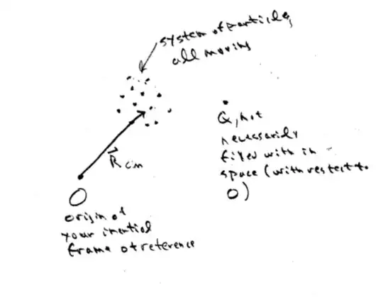

Let $O$ denote the origin of the inertial system you are using to evaluate motion. For a "system of particles" (not necessarily a rigid body), the translational motion of the center of mass is always specified as $\vec F_{ext} = M\vec a_{CM}$ where $\vec F_{ext}$ is the total external force, $M$ is the total mass (sum of mass of all particles) and $\vec a_{CM} = \ddot{\vec R}$ is the acceleration of the center of mass, where $\vec R$ is the position of the center of mass relative to $O$. Torque and angular momentum depend on the point about which they are evaluated, call it $Q$, a point not necessarily fixed in space relative to the fixed origin $O$. If you choose the center of mass as the point $Q$, it is always true that $\vec \tau_{CM} = {d \vec L_{CM} \over dt}$ even if the center of mass is accelerating, where $\vec \tau_{CM}$ is the net external torque for all the particles and $\vec L_{CM}$ is the total angular momentum of all the particles, both evaluated with respect to the center of mass. You can choose any point $Q$ besides the center of mass, but the simple relationship just provided between torque and angular momentum is not true in general.
The textbook Mechanics by Symon discusses all this is detail, and provides the relationship between torque and angular momentum about a general point, not necessarily the center of mass. A rigid bar is a special case of a system of particles for which the distance between any two points in the bar does not change.
For problems where the rigid body is unconstrained in space the point $Q$ is typically taken as the center of mass; (for problems where the rigid body is constrained to rotate about a fixed point, that point is typically taken as $Q$). [Symon, Mechanics]

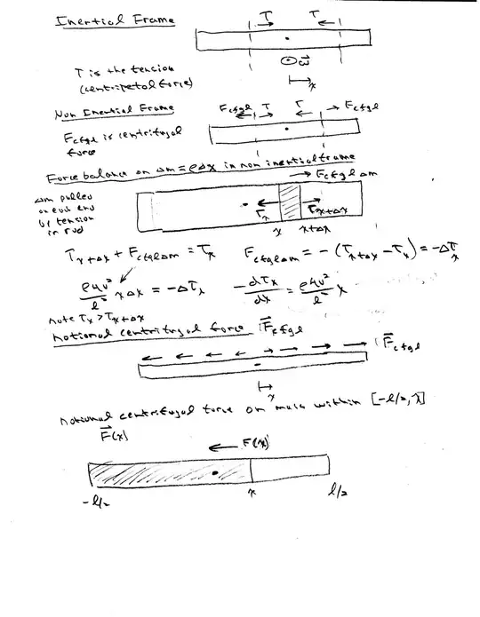

A little more discussion may help understand the result developed earlier by @Claudio Saspinski. Rotation with respect to the center of mass is evaluated. @Claudio Saspinski uses a non-inertial reference frame rotating with the bar, and in this frame the fictitious centrifugal force at a point in the bar acting outward along the bar from the center of mass is equal in magnitude and opposite to the centripetal force acting inward toward the center of mass along the bar to keep the bar stationary (not rotating) in this frame. For an inertial frame (non rotating), there is no centrifugal force, and the only force is the centripetal force acting inward. The centripetal force is the name given to the actual force that causes inward acceleration, here the tension force in the bar. That is, the tension is the centripetal force.
The figure below shows the forces in both the inertial and non-inertial frames, and provides a force balance in the non-inertial frame on a mass element $\Delta m$ where $l$ is the length of the rod and $\rho$ is the linear density (mass per unit length) of the bar. Note that $\Delta m$ is stretched outwards at both ends due to the tension on the bar.
This result obtained by @Claudio Saspinski can be understood as follows.
$$dF(x) = \rho \frac{4v^2}{l^2} x dx$$ is the centrifugal force on mass $dm = \rho dx$ located at position $x$, per the earlier answer. Therefore, the centrifugal force on the total mass within $[-{l \over 2}, x]$ is $$(1) F(x) = \int_{-{l \over 2}}^{x} \rho {4v^2 \over l^2} x dx = \frac{1}{2}\rho v^2(4\frac{x^2}{l^2} - 1)$$ Note that at $x = {-l \over 2}$, $F(x) = 0$ since $[-{l \over 2}, -{l \over 2}]$ contains no mass, and at $x = {l \over 2}$, $F(x) = 0$ since for the mass within $[-{l \over 2}, 0]$ the centrifugal force is in the opposite direction but equal in magnitude to the centrifugal force for the mass within $[ 0, {l \over 2}]$. Note that for ${-l \over 2} < x < {l \over 2}$ the centrifugal force $F(x)$ is in the $-x$ direction, since most of the mass within $[{-l \over 2}, x]$ is to the left of the center of mass. $F(0)$ is the maximum value of $F(x)$, and $F(0)$ is in the $-x$ direction. See the figure below.
The centripetal force is equal in magnitude and opposite in direction to the centrifugal force so $-F(x)$ is the centripetal force (the tension) on the total mass within $[-{l \over 2}, x]$. Note that the centripetal force $-F({l \over 2}) = 0$. That is, there is no net force on the total bar in the inertial frame so there is no motion of the center of mass of the bar.
The centrifugal (and centripetal) force per unit mass is dependent of the location of the unit mass, since the centrifugal force $m\omega ^2 x$ on a mass $m$ depends on the location of the mass $x$. This is different from the force of gravity. For the horizontal bar at rest on a flat surface, the force of gravity on a mass $dm = \rho dx$ equals $\rho gdx$ and is independent of $x$. The force of gravity on a section of the bar within $[-{l \over 2}, x]$ is $\rho g (x + {l \over 2})$, where $\rho (x + {l \over 2})$ is the mass within $[-{l \over 2}, x]$.

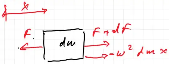

The "centripetal force" on a small mass element is
$$F+dF-F-dm\,\omega^2\,x=0\quad\Rightarrow\\dF=dm\,\omega^2 \,x\\ \text{with}\quad dm=A(x)\,\rho\,dx=A\,\rho\,dx $$
you obtain
$$F=A\,\rho\,\omega^2\int x\,dx=\frac 12 A\,\rho\,\omega^2\,x^2+c\\ \text{with}\quad F(L/2)=0\quad\Rightarrow c=-\frac 18\,A\rho\,{\omega}^{2}L^2$$
thus $$F(x)=\frac 12\,A\,\rho\,\omega^2\left(x^2-\frac{L^2}{4}\right) \quad, 0\le x\le \frac L2$$
you can obtain the angular velocity $~\omega~$ from the EOM
$$I_{\text{CM}}\,\dot\omega=\tau\quad,I_{\text{CM}}=\frac{m\,L^2}{12}$$
