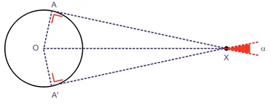

If the Sun is the sphere centered in $O$, and the point on Earth that is hit by its rays is $X$ (obviously not at the correct scale in this picture), according to my calculations:
$\alpha = 2 \cdot \arcsin \frac {OA}{OX}$
Given that:
$OA \approx 7 \cdot 10^5 \ km$
$OX \approx 1.5 \cdot 10^8 \ km$
$\alpha = 2 \cdot \arcsin \frac {7 \cdot 10^5}{1.5 \cdot 10^8} \approx 2 \cdot 0.0047 \ rad \approx 0.53 \ deg$
So OK, the angle is pretty small.
But still one might be able to detect some haze around the contour of the shadow, or am I wrong?

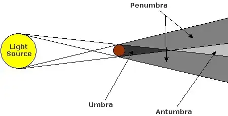

An extended light source causes a shadow consisting of umbra, penumbra and antumbra
Only in the umbra (the core of the shadow) is the light source completely blocked. The other regions are partially lit be the light source. And you can see from the graphic that it depends on where you put your screen to observe the shadow. If you place it right behind the object casting the shadow, the latter will consists solely of an umbra (i.e. creating a dark, sharp shadow). If you go further away from the object, the umbra will become smaller and eventually disappear altogether, whilst the penumbra (the diluted shadow) becomes bigger.
Thomas
  • 2,836
Imagine you hold an object in front of the Sun. Now slowly move it away so the sun becomes visible. The Sun will appear bit by bit (she's no point source). The amount of light you receive increases bit by bit, corresponding to a shadow diminishing bit by bit, i.e. an unsharp shadow.

Consider the rays from point A on your diagram. @Thomas' diagram is not drawn to scale for the case of the source being the sun but because of the distance to the sun, the two rays from A would be very close to parallel. Likewise for the two rays from B. But the rays from A are not parallel to the rays from B.
