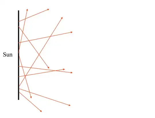

Close to the surface of the Sun, the light it emits is not in parallel beams at all. It sends photons out in pretty much every direction at random, like this:
But the Sun is far away from Earth. Most of those photons don't reach the Earth because they're heading in the wrong direction. Only those photons that happen to be heading toward the Earth actually get there - and the photons that are heading to the Earth are all heading in more or less the same direction. So the photons that actually reach the Earth are all travelling in more or less parallel directions.

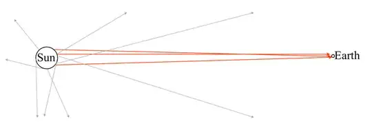

Below I've drawn the photons that reach the Earth in red, and the other photons in grey. You can see that the red ones are more or less parallel. (In reality, the Earth is further away than that, so the photons are more parallel than in the diagram.)

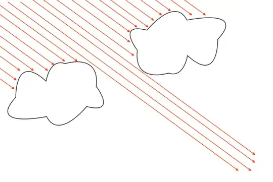

To answer your last question: sunbeams are formed when a gap in the clouds lets some light through, like this:
Photons from the Sun are always travelling in more or less the same direction, because they all came from the Sun, but it's easier to notice this when the light is concentrated in one particular place like this.
Finally, we have to explain why you're able to see the beam at all. This is just because some of the photons in the beam collide with particles in the atmosphere, which scatter them in all directions, and some of these scattered photons happen to hit your eye.

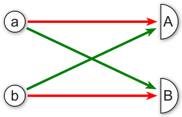

The Sun rays are not exactly parallel. They seem parallel as "Phonon" says, see her comments, but at a precise examination they are not so. Are you aware of the Hanbury Brown Twiss experiment? Look in Wikipedia at the site
http://en.wikipedia.org/wiki/Hanbury_Brown_and_Twiss_effect,
and see the lower picture in that article. I copied the picture below. The experiment was done by observing the star Sirius but with our Sun it can be done also. In short, rays coming from a points $a$ on the star's disk, reach on the Earth two points, A and B, and so do rays from another point $b$ from the star's disk.
