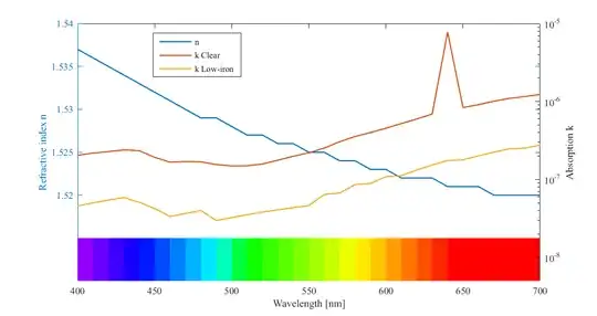

Now let's see how these theories apply to the real world. A research work reported the complex refraction index, in a wide range of wavelengths, of multiple types of glass. As used in the cited paper, glass has a complex refraction index. $$\begin{align} n_c &={} n - j\kappa \\ \varepsilon_{cr} &={} n_c^2 \end{align}$$ ($\kappa$ is not $k$. ) That is, $$\begin{align} \varepsilon'_{r} - j\varepsilon''_{r} &={} \left( n^2 - \kappa^2 \right) - j 2 \kappa n \\ &\Rightarrow{} \left\{\begin{matrix} \varepsilon'_{r} &=& n^2 - \kappa^2 \\ \varepsilon''_{r} &=& 2 \kappa n \end{matrix}\right. \end{align}$$
I plotted the refractive index $n$ and absorption rate $\kappa$ for two types of soda-lime glass in the visible wavelength range, using the data from the cited paper. One is "clear" glass, which looks clear but contains iron impurity. It is obvious that the iron element will cast a green tint on the final product, and therefore people are making a "low-iron" type of glass like Starphire for their aquatic pets. I mapped the wavelength to RGB color using this formula. n and k vs wavelength
Apparently, the "clear" glass with iron impurity has an absorption peak for red light. Other than that, both the "clear" glass and "low-iron" glass have similar trends in absorption vs wavelength. The longer the wavelength, the more the absorption. Although the deviation is tiny, it can still make a difference. Since the glass absorbs a slightly larger portion of the red light, the "color" or what's left in the transmitted light seems to have a hint of green. Also I suspect that the reason it looks "green" rather than "cyan" (missing red) is because human eyes are more sensitive to green lights. But I don't have reference here, so don't quote me on this.

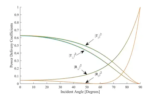

I plotted the power delivery coefficients $\left| T \right|^2$ and $\left| R \right|^2$ vs incident angle for the perpendicular and parallel polarization cases. Three wavelengths are included: blue (450 nm), green (500 nm) and red (620 nm).
T and R squared vs angle
You can see there is little deviation depending on the wavelength; that is because $n$ is about the same for all frequencies, and $\kappa$ is fairly small compared to $n$. This is why the reflection of things have the their original colors.

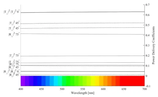

This plot shows the really tiny variation in these coefficients when the wavelength changes for three incident angles.
T and R square vs wavelength
The small deviation in $n$ vs wavelength causes the dispersion, or the splitting of the colors when light passes through lens. But that's a different story.
For the small-angle region of up to 15 degrees, the reflection for all colors and both polarizations is constantly about 4%.

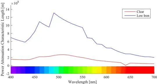

$\alpha$ has a unit of $\text{m}^{\text{-1}}$. We can define $L_a = \frac{1}{2 \alpha}$ as the power attenuation characteristic length. It is pretty long, and looks like this.
power attenuation char length vs wavelength

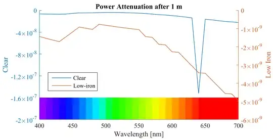

Below is a comparison between the performance of the "clear" and "low-iron" glass. The question is, behind a 1-meter thick layer of glass, what color does it look like?
power attenuation vs wavelength
No surprise. The "low-iron" glass looks clearer than the "clear" glass.
