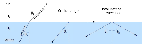

As you stated, the degree of green is directly dependent on the thickness of glass you stare at (Beer-Lambert law). It actually comes from the absorption of the other wavelengths by the glass.
Due to refraction, even when you look at the glass from a grazing angle in the air, the light rays bend to a higher angle in the glass which makes the light path through the glass shorter (figure 2).
On the contrary, when you stare at the glass from the edge, total internal reflection makes the light rays travel through the whole length of the glass to your eye (figure 3).
- 355
Even when held at a glancing angle, the light within the glass follows a relatively short path. As light crosses the boundary between the air an the glass its angle changes (refraction). Light that leaves the glass at a glancing angle and enters your eye was traveling much closer to perpendicular to the surface when it was within the glass. It hasn't passed through a thick layer, hasn't encountered many impurities, and hence hasn't had its color changed much.
