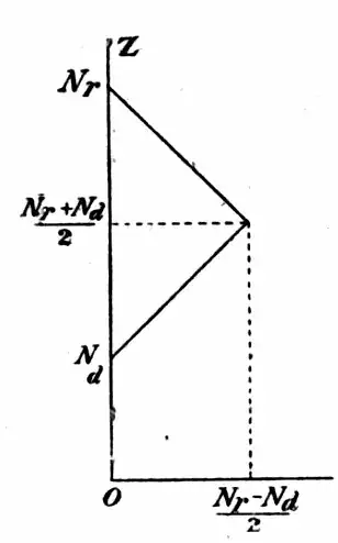

There's a lot of notation in Robb (1936) to sift through.
So far, I have been unable able to spot the two-times formula.
However, the two-times formula for the square-interval can be seen here in
Robb's (1911) Optical Geometry of Motion ( https://archive.org/details/opticalgeometryo00robbrich )
from page 6
[on page 5, Robb defines $N_d$ the "index of departure" and $N_r$ the "index of return".]
We shall define the distance of any particle P from A as measured by $$\frac{N_r -N_d}{2}.$$
In our permanent system this quantity remains fixed for each particle. If then we select any particle $P$, and let $$\frac{N_r -N_d}{2}=k,$$ we have $$N_r N_d= \left(\frac{N_r +N_d}{2}\right)^2 -k^2.$$
and then on page 8 appears this figure:
Robb-1911-p.8
(Interesting...
but I don't expect to find the https://en.wikipedia.org/wiki/Cayley%E2%80%93Menger_determinant and https://mathworld.wolfram.com/Cayley-MengerDeterminant.html in Robb's work.)
[By the way, I think this 1911 work is where "rapidity" gets its name from.]
