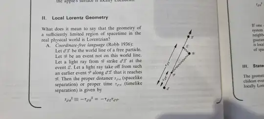

What does it mean to say that the geometry of a sufficiently limited region of spacetime in the real physical world is Lorentzian?
A. Coordinate-free language (Robb 1936):
Let $\mathcal{AZ}$ be the world line of a free particle. Let $\mathcal{B}$ be an event not on this world line. Let a light ray from $\mathcal{B}$ strike $\mathcal{AZ}$ at the event $\mathcal{Q}$. Let a light ray take off from such an earlier event $\mathcal{P}$ along $\mathcal{AZ}$ that it reaches $\mathcal{B}$. Then the proper distance $s_\mathcal{AB}$ (spacelike separation) or proper time $\tau_\mathcal{AB}$ (timelike separation) is given by $$ s_\mathcal{AB}^2 \equiv - \tau_\mathcal{AB}^2 = - \tau_\mathcal{AQ}\tau_\mathcal{AP}.$$
The core of my question is why proper distance squared is equivalent to the negative of proper time squared?
The metric convention used in the book is (-+++).
From my understanding, the square of the proper time is proportional to the square of the invariant line element spacetime interval, ds^2. I don't know where the proper length comes into that though.
As @PaulT says, their notation is confusing.
For thoroughness, that passage should probably should say:
(in the (-+++)-signature convention) for a 4-vector displacement $\bf \vec s=\mathcal{AB}$, the square-interval is $$\Delta \bf s^2_\mathcal{AB}= (-\tau_\mathcal{AQ}\tau_\mathcal{AP}).$$
  • When 4-vector $\bf \vec s=\mathcal{AB}$ is spacelike, then (in the (-+++)-signature convention) $\bf \Delta s^2_\mathcal{AB}>0$, and the proper-distance $s_\mathcal{AB}$ along that spacelike-displacement is defined and is determined by the radar measurement $$s_\mathcal{AB}^2 \equiv +\Delta \bf s^2_\mathcal{AB} = (-\tau_\mathcal{AQ}\tau_\mathcal{AP})>0,$$ with chronological ordering $\mathcal P < \mathcal A < \mathcal Q$ along $\mathcal{AZ}$ (so that $\tau_{\mathcal{AQ}}>0$ and $\tau_{\mathcal{AP}}<0$).
  • When 4-vector $\bf \vec s=\mathcal{AB}$ is timelike, then (in the (-+++)-signature convention) $\bf \Delta s^2_\mathcal{AB}<0$, and the proper-time $\tau_\mathcal{AB}$ along that timelike-displacement is defined and is determined by the radar measurement $$\tau_\mathcal{AB}^2 \equiv -\Delta \bf s^2_\mathcal{AB}= -(-\tau_\mathcal{AQ}\tau_\mathcal{AP})>0$$ with chronological ordering $\mathcal A < \mathcal P < \mathcal Q$ (so that $\tau_{\mathcal{AQ}}>0$ and $\tau_{\mathcal{AP}}>0$).
  • When 4-vector $\bf \vec s=\mathcal{AB}$ is lightlike, then $\bf \Delta s^2_\mathcal{AB}=0$
    with either $\mathcal A=\mathcal P\leq \mathcal Q$ (for $\mathcal{AB}$ for future-lightlike) or $\mathcal P\leq \mathcal Q=\mathcal A$ (for $\mathcal{AB}$ for past-lightlike) along $\mathcal{AZ}$.
On the next page, they show that, in the $\mathcal{AZ}$-frame with conveniently chosen axes that
$\tau_\mathcal{AP}=\Delta t_{\mathcal{AB}}-\Delta x_{\mathcal{AB}}$ and
$\tau_\mathcal{AQ}=\Delta t_{\mathcal{AB}}+\Delta x_{\mathcal{AB}}$
so that $\tau_\mathcal{AQ}\tau_\mathcal{AP}=\Delta t_{\mathcal{AB}}^2 - \Delta x_{\mathcal{AB}}^2$ and thus, we see the signature with $$(-\tau_\mathcal{AQ}\tau_\mathcal{AP})= -\Delta t_{\mathcal{AB}}^2 + \Delta x_{\mathcal{AB}}^2.$$
