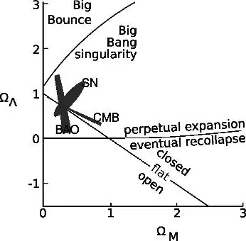

There are three main techniques for measuring the cosmological parameters $\Omega_\Lambda$ (density of dark energy) and $\Omega_M$ (density of matter): redshifts of supernovae, CMB measurements, and measurements of baryon acoustic oscillations (BAO). Each of these is individually sufficient to rule out a cosmology without any dark energy ($\Omega_\Lambda=0$). Combining all three of them gives a consistency check and also results in a better determination of $\Omega_\Lambda$ and $\Omega_M$ than could be obtained from one of them alone. The BAO technique is most sensitive to $\Omega_M$, supernovae to $\Omega_\Lambda-\Omega_M$, and CMB to $\Omega_\Lambda+\Omega_M$. The figure below shows the cosmological parameters of our universe, after Perlmutter 1998 and Kowalski 2008. The three shaded regions represent the 95% confidence regions for the three types of observations.
The cosmological parameters of our universe, after Perlmutter 1998 and Kowalski 2008. The three shaded regions represent the 95% confidence regions for the three types of observations.
The density of matter $\Omega_M$ can be broken down into baryonic and nonbaryonic matter (dark matter). There are several ways we can do this (Roos 2012):
(1) We have models of nucleosynthesis during the era shortly after the Big Bang (before the formation of the first stars). The observed relative abundances of hydrogen, helium, and deuterium cannot be reconciled with the density of nonrelativistic matter inferred from the observational data. If the inferred mass density were entirely due to baryonic matter, then nuclear reactions in the dense early universe should have proceeded relatively efficiently, leading to a much higher ratio of helium to hydrogen, and a much lower abundance of deuterium.
(2) The existence of nonbaryonic matter is also required in order to reconcile the observed density of galaxies with the observed strength of the CMB fluctuations.
(3) In merging galaxy clusters it has been observed that the gravitational potential is offset from the radiating plasma.
