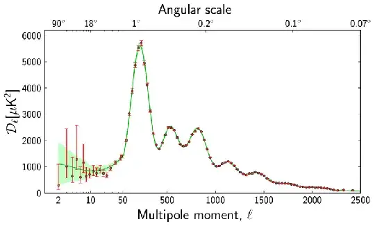

The discovery of CMB (cosmic microwave background) is of great importance. It is the radiation from a very young universe, just when neutral Hydrogen could form. CMB map is basically a map of intensity of this primordial radiation from different sections of the sky. The difference between the intensities of two different parts of the sky give something called as "Power Spectrum". Which can be seen below.
The peaks of the spectrum tells us about the history of Universe. It looks like a damped oscillation, in which case the peaks had to be monotnically decreasing. But we see that some peaks are alleviated (for example, the third peak) which puts a constrain on the percentage of amount of Dark matter in the Universe. Similarly, we fit using Monte-Carlo codes, to get the best fit of data. Hence we can know to a good precision what should be the amount of matter, dark energy, dark matter etc should be there. From a similar analysis of Supernova (TypeIa) data we can also limit the distribution of energy densities to various factors.
