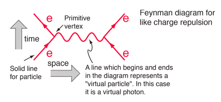

You are talking in the classical frame. Here is the first order Feynman diagram of electron repulsion:
ee
If you apply a force on one of the incoming electrons different,new, diagrams are needed to describe the interaction at the quantum level.
