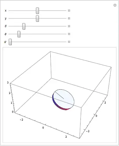

Adjusting the parameters on the transformation equation: changing parameters

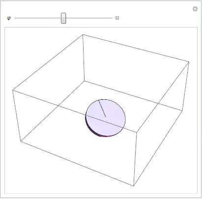

Applying partial constraint 1 to visualize rolling without slipping
constraint 1

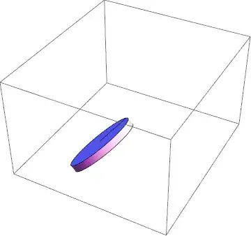

Visualizing partial constraint 2

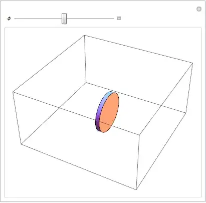

constraint 3
Visualizing constraint 3
