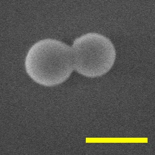

The current world record for the fastest spinning object is held by this nanoparticle made of silica (sand, quartz), which is levitated and spun using lasers to achieve a rotation rate exceeding $300$ billion RPM = $5$ GHz.
Fastest-spinning object
The fastest-spinning object ever created is a nano-scale rotor made from silica at Purdue University. This image of the rotor at rest was created using a scanning electron microscope. For scale, the yellow bar in the image is $200$ nanometers.
The radius of the balls composing the nano-rotor is ~$80$ nm. The speed of sound in quartz is ~$5800$ m/s, which is around $c/52000$, and the nano-rotor is getting close to that speed.
The (rest) mass of the nano-rotor is ~$5.7×10^{-15}$ g. Its kinetic energy is ~$5.0×10^{-11}$ J, which is ~$10^{13}$ times smaller than the rest energy. So to measure the mass increase, the measurements need at least $13$ digits of precision. That level of experimental precision is very difficult to achieve.
