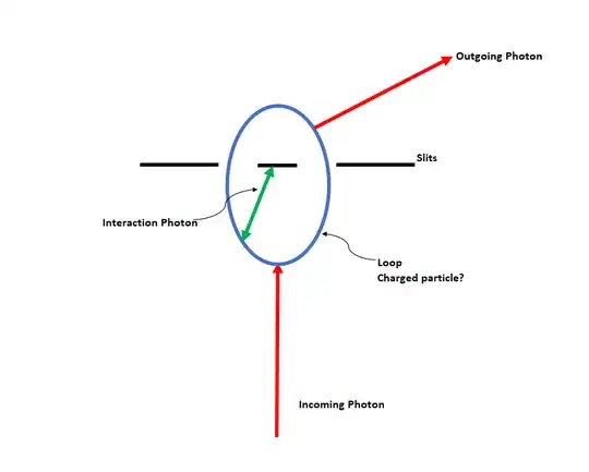

I have a candidate. The lowest order loop expansion I can come up with looks like so. (Apologies. I don't have a drawing package that does electrons and photons properly. I'd be glad to be pointed at one if it exists.)
So very schematically: The photon must split into two parts, which have to start as charged particles. Otherwise they could not be interacting with the photon. These must go one on each side, otherwise there can't be any interference from the two slits. The slits provide an elastic interaction photon that provides momentum, but no change in energy.
I am presuming that the interaction photon can arise from any point on the slits, and interact with any part of the loop.
Is this what is going on? There ought to be a "well known" experiment that sees that charged loop if it is there. Say by imposing an electric field parallel to the plane of the slits.

You do not state the level of your physics background in your profile, but from your question, I assume that you are not familiar with quantum mechanics.
There is no "charged loop " as you imagine in your drawing.

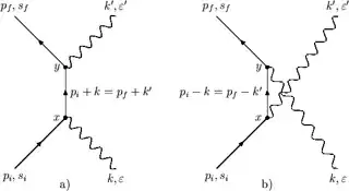

The material of the slits consists of atoms and molecules, which are neutral. Atoms have charged electrons around them and those are the ones photons will interact with. BUT electrons and photons are point particles, no extension in space that you show for the "charged" particle in your drawing. Their interactions are described mathematically by quantum field theory which gives the solutions in series terms of decreasing in magnitude order. The first order diagrams and calculations for electron photon scattering can be seen here
compt
In the first diagram (figure 7.7a), the incident photon ($k,\varepsilon$) is absorbed by the incident electron ($p_i,s_i$) and then the electron emits a photon ( $k^\prime,\varepsilon^\prime$) into the final state. In the second diagram (figure 7.7b), the incident electron ($p_i,s_i$)
This is for a free electron. It looks a bit like your diagram but it corresponds to mathematical formulas that calculate the probability of scattering in a given direction.
You can see that from momentum conservation the directions change.
When the electron is tied up in the atoms of the slit, it becomes more complicated mathematically , but momentum conservation is a strict rule. The atom on which the electron is bound takes up the momentum and transfers it to the lattice it belongs to.

There is no charged loop and no extra photon.
The one and unique photon in the two slits experiment acts as a wave. It does not just "split in two parts" to go through each slit. The wave "fills" the full widths of both two slits at the same time and gets "kicks" from all four ends of the slits at the same time.

The diffraction pattern is not formed by photons splitting up into pairs of charged particles. Unless the light has a frequency that is high enough to produce electron-positron pairs, the contribution of those virtual loops that are shown in the diagram would be negligible.
