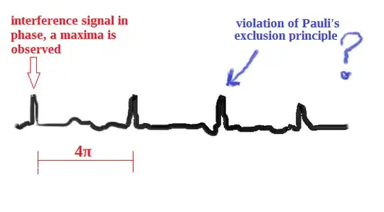

However, as these experiments show for every of Larmor rotation period, the two beams get momentarily in phase and a maxima in the signal output is generated due constructive interference:
violation of PEP?
My question here is, at the points where the maxima in the interference signal are observed as shown above, meaning the two beams are monetarily in phase, do these events not violate the Pauli's exclusion principle?

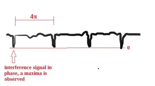

Thus according to the above interpretation IMO the signal output will be like this:
no violation?
But then how can be the two beams be in phase and at the same time having a destructive interference? And most importantly, if the two neutron beams combined end up having anti parallel spin because the Pauli's exclusion principle, how then can these experiments measure the 720° rotation Dirac Belt trick characteristic of these fermions (i.e. neutrons)?

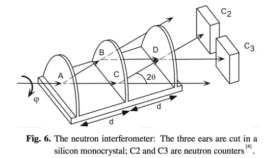

@rob's answer gives more detail about how the experiment is done. To complement those details, here's a diagram from reference 2, showing an oblique view of a typical neutron interferometer (see @rob's answer for typical dimensions):
As the arrows indicate, each individual neutron enters from the left. At point A, the neutron's wavefunction is diffracted into a two-peaked wavefunction. Those two branches of the wavefunction are diffracted again at points B and C, respectively, so that the wavefunction emerging from the middle slab has four peaks. Two of those peaks converge back together at point D, and their relative phases determine the relative intensities of the two peaks of the wavefunction that emerge downstream of point D. The relative intensities of those two peaks determine the relative probabilities of detecting the neutron at either $C_2$ or $C_3$. The neutron can only be detected by one of them, not by both, because it's just one neutron. But after repeating this with lots of neutrons, the cumulative numbers of detections registered by $C_2$ and $C_3$ tell us what the relative probabilities were. (There is also some probability that neither of those detectors will register the neutron, because the other two branches of the wavefunction, the ones that are shown bypassing the third slab in the figure, also have nonzero amplitudes.)

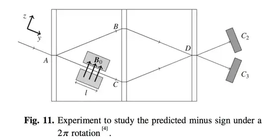

A top view of the interferometer in a $4\pi$-rotation experiment is shown in this diagram from reference 2:
The points A,B,C,D are the same as in the previous oblique view. In this case, one of the branches of that single-neutron wavefunction goes through a magnetic field that is tuned to produce a known amount of precession. That affects the relative phase of those two branches of the single-neutron wavefunction at point D. By repeating the whole experiment many times with different magnetic-field strengths, we can map out how the relative probabilites at $C_2$ and $C_3$ depend on the magnetic field, and therefore on the amount of precession experience by one of the two branches of the neutron's wavefunction.
