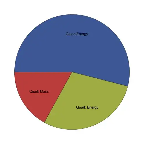

The basic idea is the following. Protons are described by QCD, and the QCD energy-momentum tensor is $$ T^{\mu\nu} = \frac{1}{2} \bar\psi i\gamma^{(\mu} \stackrel{\leftrightarrow}{D}\mbox{}^{\nu)}\psi +\frac{1}{4}g^{\mu\nu}F^2 - F^{\mu\alpha}F_{\alpha}^{\nu} $$ where $\psi$ is a quark field, $\stackrel{\leftrightarrow}{D}$ is a symmetrized gauge covariant derivative, $(\mu\nu)$ are symmetrized vector indices, and $F^{\mu\nu}$ is color field strength tensor. The Hamiltonian is $$ H = \int d^3x\, T^{00} $$ and the proton mass is $$ m_p = \langle p(\vec{k}=0) | H | p(\vec{k}=0)\rangle $$ where $| p(\vec{k}=0)\rangle$ is a proton state with zero momentum. I can now ask whether it is possible to decompose $m_p$ into contributions from various terms in the stress tensor, and whether these terms can be independently measured.
The answer is "yes", modulo some of the ambiguities mentioned above (the total mass of the proton is certainly well defined, but there may be ambiguities in individual terms that cancel in $m_p$). Experimental input on individual terms comes from deep inelastic scattering (which measures trace free matrix elements of the quark and gluon energy-momentum tensor), and pion-nucleon scattering (which measures quark mass contributions). Individual matrix elements can also be determined in lattice QCD.
There are many details, discussed in the papers cited above. A typical result is shown in this figure (taken from a report on a future electron ion collider) which shows fractional contributions from quarks and gluons (with quark mass contributions separated out)

Also, one can attempt to take the gluon field energy and split into an electric part ("kinetic energy") and a magnetic part ("potential energy"). This separation depends on the scale, but the magnetic part does indeed come out negative. A simple analysis (using numbers from the paper cited above) gives $$ \frac{1}{2}\langle p| E^2 p\rangle \simeq 850\, {\rm MeV}\quad\quad \frac{1}{2}\langle p| B^2 p\rangle \simeq -525\, {\rm MeV} $$ A similar separation cannot be done for quarks, because there is no gauge invariant way to decompose the covariant derivative $\bar\psi \gamma\cdot D\psi$ into a kinetic and an interaction term.
