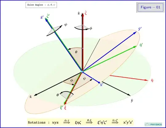

A rotation of coordinate axes via the Euler angles $\:\psi,\theta,\phi \:$ is represented by the matrix \begin{equation} \!\!\!\! \mathrm A\plr{\phi,\theta,\psi}\e \begin{bmatrix} \hp\m\cos\psi\cos\phi\m\cos\theta\sin\phi\sin\psi& \hphantom\p\cos\psi\sin\phi\p\cos\theta \cos\phi\sin\psi &\sin\psi\sin\theta \vp\\ \,\m\sin\psi\cos\phi\m\cos\theta \sin\phi \cos\psi&\,\m\sin\psi\sin\phi\p\cos\theta\cos\phi \cos\psi&\cos\psi\sin\theta \vp\\ \sin\theta \sin\phi&\m\sin\theta \cos\phi&\cos\theta\vp \end{bmatrix} \tag{A-01}\label{A-01} \end{equation} according to the following scheme \begin{equation} \bl{xyz} \quad \stackrel{\bl{\phi,\,z}}{\bl\Longrightarrow} \quad {\color{red}{\bl{\xi \eta \zeta}} } \quad \stackrel{\bl{\theta,\,\xi}}{\bl\Longrightarrow} \quad {\color{green}{\bl{\xi' \eta' \zeta'}}} \quad \stackrel{\bl{\psi,\,\zeta'}}{\bl\Longrightarrow} \quad {\color{blue}{\bl{x'y'z'}}} \tag{A-02}\label{A-02} \end{equation} as shown in Figure-01.
The first rotation $\:\mathrm D\:$ is around axis $\:\bl z\:$ by angle $\:\phi$, so $\:\bl{\zeta\equiv z}$. The second rotation $\:\mathrm C\:$ is around axis $\:\bl\xi\:$ (the $''$new $\:\bl x\:$-axis$''$) by angle $\:\theta$, so $\bl{\xi'\equiv\xi}$. The third rotation $\:\mathrm B\:$ is around axis $\:\bl{\zeta'}\:$ by angle $\:\psi\:$, so $\:\bl{z'\equiv\zeta'}$.
Consequently we have \begin{equation} \mathrm A\plr{\phi,\theta,\psi}\e\mathrm B\plr\psi\mathrm C\plr{\theta}\mathrm D\plr{\phi} \tag{A-03}\label{A-03} \end{equation} where \begin{equation} \begin{split} \mathrm D\plr{\phi}&\e \begin{bmatrix} \hphantom\m\cos\phi&\sin\phi&\:\:0\:\:\vp\\ \m\sin\phi&\cos\phi&\:\:0\:\:\vp\\ \hphantom\m0&0&\:\:1\:\:\vp \end{bmatrix}\\ \mathrm C\plr{\theta}&\e \begin{bmatrix} \:\:1\:\:&\hphantom\m0&0\:\vp\\ \:\:0\:\:&\hphantom\m \cos\theta &\sin\theta\:\vp\\ \:\:0\:\:&\m\sin\theta&\cos\theta\:\vp \end{bmatrix}\\ \mathrm B\plr{\psi}&\e \begin{bmatrix} \hphantom\m\cos\psi &\sin\psi&\:0\:\:\vp\\ \m\sin\psi &\cos\psi &\:0\:\:\vp\\ \hphantom\m0&\hphantom\m0&\:1\:\:\vp \end{bmatrix}\\ \end{split} \tag{A-04}\label{A-04} \end{equation} Each one of the rotation matrices $\:\mathrm{A,B,C,D}\:$ is orthonormal with inverse its transpose.
Note that the transformation matrix $\:\mathrm A\:$ of equation \eqref{A-01} represents a passive rotation, that is a change of the coordinates between the frames $\:\bl{xyz}\:$ and $\:\bl{x'y'z'}\:$ due to the rotation of the former to the latter. It's not an active transformation that is it doesn't represent rotation of a rigid body.

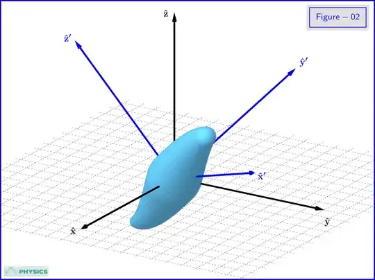

To express the angular velocity of a rotating rigid body via the Euler angles in the $\underline{\texttt{space frame}\:\:\bl{xyz}}\:$ we attach to this body the $\underline{\texttt{body frame}\:\:\bl{x'y'z'}}\:$ shown in Figure-02.
Now we have an active rotation so the transformation matrix $\:\mathcal A\:$ which represents this body rotation is the inverse of that representing the passive one $\:\mathrm A$ \begin{equation} \mathcal A\e\mathrm A^{\m 1}\e\mathrm A^{\bl\top} \tag{B-01}\label{B-01} \end{equation} So \begin{equation} \mathcal A\e\mathrm D^{\m 1}\mathrm C^{\m 1}\mathrm B^{\m 1}\e\mathrm D^{\bl\top}\mathrm C^{\bl\top}\mathrm B^{\bl\top} \tag{B-02}\label{B-02} \end{equation} or \begin{equation} \mathcal A\e\mathcal D\,\mathcal C\,\mathcal B \tag{B-03}\label{B-03} \end{equation} where \begin{equation} \begin{split} \mathcal D&\e \begin{bmatrix} \hp\m\cos\phi&\m\sin\phi&\hp\m 0\vp\\ \hp\m\sin\phi&\hp\m\cos\phi&\hp\m 0\vp\\ \hp\m 0&\hp\m 0&\hp\m 1\vp \end{bmatrix}\e\mathrm D^{\m 1}\e\mathrm D^{\bl\top}\\ \mathcal C & \e \begin{bmatrix} \hp\m 1&\hp\m 0&\hp\m 0\:\vp\\ \hp\m 0&\hp\m\cos\theta&\m\sin\theta\:\vp\\ \hp\m 0&\hp\m\sin\theta&\hp\m\cos\theta\:\vp \end{bmatrix}\e \mathrm C^{\m 1}\e \mathrm C^{\bl\top}\\ \mathcal B & \e \begin{bmatrix} \hp\m\cos\psi&\m\sin\psi&\hp\m 0\vp\\ \hp\m\sin\psi&\hp\m\cos\psi&\hp\m 0 \vp\\ \hp\m 0&\hp\m 0&\hp\m 1\vp \end{bmatrix}\e\mathrm B^{\m 1}\e\mathrm B^{\bl\top}\\ \end{split} \tag{B-04}\label{B-04} \end{equation} Note that in order to express the body rotation via the Euler angles we apply a first rotation $\:\mathcal B\:$ which is a rotation around the $\underline{\text{space}}$ $\:\bl z\m$axis by an angle $\:\psi$, then a second rotation $\:\mathcal C\:$ which is a rotation around the $\underline{\text{space}}$ $\:\bl x\m$axis by an angle $\:\theta\:$ and finally a third rotation $\:\mathcal D\:$ which is a rotation around the $\underline{\text{space}}$ $\:\bl z\m$axis by an angle $\:\phi$. In the end the two frames, space and body, are found in the arrangement of Figure-01.

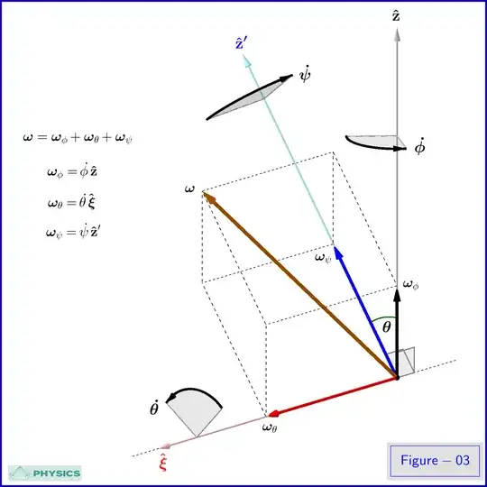

The angular velocity $\:\bl\omega\:$ of our case will be determined by the antisymmetric matrix $\:\dot{\mathcal A}\,\mathcal A^{\bl\top}$. For this we take advantage of the composition $\:\mathcal A \e \mathcal{ D\, C\, B}\:$ so we have \begin{equation} \begin{split} \dot{\mathcal A}\mathcal A^{\bl\top}&\e\plr{\dot{\mathcal D}\mathcal C\mathcal B\p\mathcal D\dot{\mathcal C}\mathcal B\p\mathcal D\mathcal C\dot{\mathcal B}}\plr{\mathcal B^{\bl\top}\mathcal C^{\bl\top}\mathcal D^{\bl\top}}\\ & \e \dot{\mathrm D}\mathcal C\mathcal B\mathcal B^{\bl\top}\mathcal C^{\bl\top}\mathcal D^{\bl\top}\p\mathcal D\dot{\mathcal C}\mathcal B\mathcal B^{\bl\top}\mathcal C^{\bl\top}\mathcal D^{\bl\top}\p \mathcal D\mathcal C\dot{\mathcal B}\mathcal B^{\bl\top}\mathcal C^{\bl\top}\mathcal D^{\bl\top}\bl\implies\\ \end{split} \nonumber \end{equation}
\begin{equation} \underbrace{\dot{\mathcal A}\mathcal A^{\bl\top}\vp}_ {\boxed{\bl\omega\x\vphantom{_\psi}}}\e\underbrace{\dot{\mathcal D}\mathcal D^{\bl\top}\vphantom{\dfrac{a}{b}}}_{\boxed{\bl\omega_\phi\x\vphantom{_\psi}}}\p\underbrace{\mathcal D\plr{\dot{\mathcal C}\mathcal C^{\bl\top}}\mathcal D^{\bl\top}}_{\boxed{\bl\omega_\theta\x\vphantom{_\psi}}}\p \underbrace{\plr{\mathcal D\mathcal C\vphantom{\dfrac{a}{b}}}\plr{\dot{\mathcal B}\mathcal B^{\bl\top}}\plr{\mathcal D\mathcal C}^{\bl\top}}_{\boxed{\bl\omega_\psi\x}}\\ \tag{B-06}\label{B-06} \end{equation} that is \begin{equation} \boxed{\:\bl\omega\e\bl\omega_\phi\p\bl\omega_\theta\p\bl\omega_\psi\vp\:} \tag{B-07}\label{B-07} \end{equation}
$\blacksquare$ The angular velocity $\bl\omega_\phi\:$ : \begin{equation} \begin{split} \bl\omega_\phi\x\e\dot{\mathcal D}\mathcal D^{\bl\top}&\e \begin{bmatrix} \m\sin\phi&\m\cos\phi&\hp\m 0\vp\\ \hp\m\cos\phi&\m\sin\phi&\hp\m 0\vp\\ \hp\m 0&\hp\m 0&\hp\m 0\vp \end{bmatrix}\:\dot{\!\!\phi} \begin{bmatrix} \hp\m\cos\phi&\hp\m\sin\phi&\hp\m 0\vp\\ \m\sin\phi&\hp\m\cos\phi&\hp\m 0\vp\\ \hp\m 0&\hp\m 0&\hp\m 1\vp \end{bmatrix}\\ &\e \:\dot{\!\!\phi} \begin{bmatrix} \hp\m 0&\m 1&\hp\m 0\vp\\ \p 1&\hp\m 0&\hp\m 0\vp\\ \hp\m 0&\hp\m 0&\hp\m 0\vp \end{bmatrix}\e \plr{\:\dot{\!\!\phi}\,\mathbf{\hat{\mathbf z}}}\x \boldsymbol \implies\\ \end{split} \nonumber \end{equation}
\begin{equation} \boxed{\:\bl\omega_\phi\e\:\dot{\!\!\phi}\,\mathbf{\hat{\mathbf z}}\vp\:} \tag{B-08}\label{B-08} \end{equation}
$\blacksquare$ The angular velocity $\bl\omega_\theta\:$ :
First \begin{equation} \begin{split} \dot{\mathcal C}\mathcal C^{\bl\top}&\e \begin{bmatrix} \hp\m 0&\hp\m 0&\hp\m 0\:\vp\\ \hp\m 0&\m\sin\theta&\m\cos\theta\:\vp\\ \hp\m 0&\hp\m\cos\theta&\m\sin\theta\:\vp \end{bmatrix} \:\dot{\!\!\theta} \begin{bmatrix} \hp\m 1&\hp\m 0&\hp\m 0\:\vp\\ \hp\m 0&\hp\m\cos\theta&\hp\m\sin\theta\:\vp\\ \hp\m 0&\m\sin\theta&\hp\m\cos\theta\:\vp \end{bmatrix}\bl\implies\\ \end{split} \nonumber \end{equation} \begin{equation} \dot{\mathcal C}\mathcal C^{\bl\top}\e \:\dot{\!\!\theta} \begin{bmatrix} \hp\m 0&\hp\m 0&\hp\m 0\vp\\ \hp\m 0&\hp\m 0&\m 1\vp\\ \hp\m 0&\p 1&\hp\m 0\vp \end{bmatrix}\e \plr{\:\dot{\!\!\theta}\,\mathbf{\hat{\mathbf x}}}\x \tag{B-09}\label{B-09} \end{equation} so \begin{equation} \begin{split} \bl\omega_\theta\x&\e\mathcal D\plr{\dot{\mathcal C}\mathcal C^{\bl\top}}\mathcal D^{\bl\top}\\ &\e\hp{\dot{\theta}} \begin{bmatrix} \hp\m\cos\phi&\m\sin\phi&\hp\m 0\vp\\ \hp\m\sin\phi&\hp\m\cos\phi&\hp\m 0\vp\\ \hp\m 0&\hp\m 0&\hp\m 1\vp \end{bmatrix} \:\dot{\!\!\theta} \begin{bmatrix} \hp\m 0&\hp\m 0&\hp\m 0\vp\\ \hp\m 0&\hp\m 0&\m 1\vp\\ \hp\m 0&\p 1&\hp\m 0\vp \end{bmatrix} \begin{bmatrix} \hp\m\cos\phi&\hp\m\sin\phi&\hp\m 0\vp\\ \m\sin\phi&\hp\m\cos\phi&\hp\m 0\vp\\ \hp\m 0&\hp\m 0&\hp\m 1\vp \end{bmatrix}\\ & \e \:\dot{\!\!\theta} \begin{bmatrix} \hp\m 0&\hp\m 0&\hp\m\sin\phi\vp\\ \hp\m 0&\hp\m 0&\m\cos\phi\vp\\ \m\sin\phi&\hp\m\cos\phi&\hp\m 0\vp \end{bmatrix}\e\plr{\:\dot{\!\!\theta}\cos\phi\,\mathbf{\hat{\mathbf x}}\p\:\dot{\!\!\theta}\sin\phi\,\mathbf{\hat{\mathbf y}}}\x \e \plr{\:\dot{\!\!\theta}\, \boldsymbol{\hat{\boldsymbol \xi}}}\x \\ \end{split} \nonumber \end{equation} that is \begin{equation} \boxed{\:\bl\omega_\theta\e\:\dot{\!\!\theta}\cos\phi\,\mathbf{\hat{\mathbf x}}\p\:\dot{\!\!\theta}\sin\phi\,\mathbf{\hat{\mathbf y}}\e\: \dot{\!\!\theta}\, \bl{\hat{\bl \xi}}\vp\:} \tag{B-10}\label{B-10} \end{equation} where \begin{equation} \bl{\hat{\bl\xi}}\e\cos\phi\,\mathbf{\hat{\mathbf x}}\p\sin\phi\,\mathbf{\hat{\mathbf y}} \tag{B-11}\label{B-11} \end{equation}
$\blacksquare$ The angular velocity $\bl\omega_\psi\:$ :
First \begin{equation} \dot{\mathcal B}\mathcal B^{\bl\top}\e \begin{bmatrix} \m\sin\psi&\m\cos\psi&\hp\m 0\vp\\ \hp\m\cos\psi&\m\sin\psi&\hp\m 0\vp\\ \hp\m 0&\hp\m 0&\hp\m 0\vp \end{bmatrix}\:\dot{\!\!\psi} \begin{bmatrix} \hp\m\cos\psi&\hp\m\sin\psi&\hp\m 0\vp\\ \m\sin\psi&\hp\m\cos\psi&\hp\m 0\vp\\ \hp\m 0&\hp\m 0&\hp\m 1\vp \end{bmatrix} \nonumber \end{equation} so \begin{equation} \dot{\mathcal B}\mathcal B^{\bl\top}\e\:\dot{\!\!\psi} \begin{bmatrix} \hp\m 0&\m 1&\hp\m 0\vp\\ \p 1&\hp\m 0&\hp\m 0\vp\\ \hp\m 0&\hp\m 0&\hp\m 0\vp \end{bmatrix} \e\plr{\:\dot{\!\!\psi}\,\mathbf{\hat{\mathbf z}}}\x \tag{B-12}\label{B-12} \end{equation} Also \begin{equation} \mathcal D\mathcal C\e \begin{bmatrix} \hp\m\cos\phi&\m\sin\phi&\hp\m 0\vp\\ \hp\m\sin\phi&\hp\m\cos\phi&\hp\m 0\vp\\ \hp\m 0&\hp\m 0&\hp\m 1\vp \end{bmatrix} \begin{bmatrix} \hp\m 1&\hp\m 0&\hp\m 0\:\vp\\ \hp\m 0&\hp\m\cos\theta&\m\sin\theta\:\vp\\ \hp\m 0&\hp\m\sin\theta&\hp\m\cos\theta\:\vp \end{bmatrix} \nonumber \end{equation} that is \begin{equation} \hp{^{\bl\top}}\plr{\mathcal D\mathcal C}\e \begin{bmatrix} \cos\phi&\m\sin\phi\cos\theta&\hp\m\sin\phi\sin\theta\vp\\ \sin\phi&\hp\m\cos\phi\cos\theta&\m\cos\phi\sin\theta \vp\\ 0&\hp\m\sin\theta&\hp\m\cos\theta\vp \end{bmatrix} \tag{B-13}\label{B-13} \end{equation} and consequently \begin{equation} \plr{\mathcal D\mathcal C}^{\bl\top}\e \begin{bmatrix} \hp\m\cos\phi&\hp\m\sin\phi&\hp\m 0\vp\\ \m\sin\phi\cos\theta&\hp\m\cos\phi\cos\theta&\hp\m\sin\theta\vp\\ \hp\m\sin\phi\sin\theta&\m\cos\phi\sin\theta&\hp\m\cos\theta\vp \end{bmatrix} \tag{B-14}\label{B-14} \end{equation} Secondly \begin{equation} \plr{\mathcal D\mathcal C\vp}\plr{\dot{\mathcal B}\mathcal B^{\bl\top}}\e \begin{bmatrix} \cos\phi&\m\sin\phi\cos\theta&\hp\m\sin\phi\sin\theta\vp\\ \sin\phi&\hp\m\cos\phi\cos\theta&\m\cos\phi\sin\theta\vp\\ 0&\hp\m\sin\theta&\hp\m\cos\theta\vp \end{bmatrix} \:\dot{\!\!\psi} \begin{bmatrix} \hp\m 0 &\m 1&\hp\m 0\vp\\ \p 1&\hp\m 0&\hp\m 0\vp\\ \hp\m 0&\hp\m 0&\hp\m 0\vp \end{bmatrix} \nonumber \end{equation} so \begin{equation} \plr{\mathcal D\mathcal C\vp}\plr{\dot{\mathcal B}\mathcal B^{\bl\top}}\e\:\dot{\!\!\psi} \begin{bmatrix} \m\sin\phi\cos\theta&\m\cos\phi&\hp\m 0\vp\\ \hp\m\cos\phi\cos\theta&\m\sin\phi&\hp\m 0\vp\\ \hp\m\sin\theta&\hp\m 0&\hp\m 0\vp \end{bmatrix} \tag{B-15}\label{B-15} \end{equation} and
\begin{equation} \begin{split} \bl\omega_\psi\x&\e\plr{\mathcal D\mathcal C\vp}\plr{\dot{\mathcal B}\mathcal B^{\bl\top}}\plr{\mathcal D\mathcal C\vp}^{\bl\top}\\ & \e\:\dot{\!\!\psi} \begin{bmatrix} \m\sin\phi\cos\theta&\m\cos\phi&\hp\m 0\vp\\ \hp\m\cos\phi\cos\theta&\m\sin\phi&\hp\m 0\vp\\ \hp\m\sin\theta&\hp\m 0&\hp\m 0 \vp \end{bmatrix} \begin{bmatrix} \hp\m\cos\phi&\hp\m\sin\phi&\hp\m 0\vp\\ \m\sin\phi\cos\theta &\hp\m\cos\phi\cos\theta&\hp\m\sin\theta\vp\\ \hp\m\sin\phi\sin\theta&\m\cos\phi\sin\theta&\hp\m\cos\theta\vp \end{bmatrix}\\ &\e\:\dot{\!\!\psi} \begin{bmatrix} 0&\m\cos\theta&\m\cos\phi\sin\theta\vp\\ \cos\theta&\hp\m 0&\m\sin\phi\sin\theta\vp\\ \cos\phi\sin\theta&\hp\m\sin\phi\sin\theta&\hp\m 0\vp \end{bmatrix}\\ &\e\plr{\:\dot{\!\!\psi}\sin\theta\sin\phi\,\mathbf{\hat{\mathbf x}}\m\:\dot{\!\!\psi}\sin\theta\cos\phi\,\mathbf{\hat{\mathbf y}}\p\:\dot{\!\!\psi}\cos\theta\,\mathbf{\hat{\mathbf z}}}\x\e\plr{\:\dot{\!\!\psi}\,\mathbf{\hat{\mathbf z}}'}\x\\ \end{split} \tag{B-16}\label{B-16} \end{equation} that is \begin{equation} \boxed{\:\bl\omega_\psi\e\:\dot{\!\!\psi}\sin\theta\sin\phi\,\mathbf{\hat{\mathbf x}}\m\:\dot{\!\!\psi}\sin\theta\cos\phi\,\mathbf{\hat{\mathbf y}}\p\:\dot{\!\!\psi}\cos\theta\,\mathbf{\hat{\mathbf z}}\e\:\dot{\!\!\psi}\,\mathbf{\hat{\mathbf z}}'\vp\:} \tag{B-17}\label{B-17} \end{equation} where \begin{equation} \mathbf{\hat{\mathbf z}}'\e\sin\theta\sin\phi\,\mathbf{\hat{\mathbf x}}\m\sin\theta\cos\phi\,\mathbf{\hat{\mathbf y}}\p\cos\theta\,\mathbf{\hat{\mathbf z}} \tag{B-18}\label{B-18} \end{equation} Using equations \eqref{B-07},\eqref{B-08},\eqref{B-10},\eqref{B-11},\eqref{B-17} and \eqref{B-18} we construct the following tables \eqref{Table-01} and \eqref{Table-02}. \begin{equation} \begin{array}{||c|c|c|c||} \hline \textbf{angular}&\mathbf{\hat{\mathbf x}}&\mathbf{\hat{\mathbf y}}&\mathbf{\hat{\mathbf z}}\\ \textbf{velocity}&\textbf{component}&\textbf{component}&\textbf{component}\\ \hline \bl\omega_\phi\e\:\dot{\!\!\phi}\,\mathbf{\hat{\mathbf z}}&0&0&\:\dot{\!\!\phi}\vphantom{\tfrac{\tfrac{a}{b}}{\tfrac{a}{b}}}\\ \hline \bl\omega_\theta\e\:\dot{\!\!\theta}\,\bl{\hat{\bl\xi}}&\:\dot{\!\!\theta}\cos\phi&\:\dot{\!\!\theta}\sin\phi&0\vphantom{\tfrac{\tfrac{a}{b}}{\tfrac{a}{b}}}\\ \hline \bl\omega_\psi\e\:\dot{\!\!\psi}\,\mathbf{\hat{\mathbf z}}'&\:\dot{\!\!\psi}\sin\theta\sin\phi&\m \:\dot{\!\!\psi}\sin\theta\cos\phi&\:\dot{\!\!\psi}\cos\theta \vphantom{\tfrac{\tfrac{a}{b}}{\tfrac{a}{b}}}\\ \hline \bl\omega\e\underbrace{\bl\omega_\phi\p\bl\omega_\theta \p\bl\omega_\psi}_{\:\dot{\!\!\phi}\,\mathbf{\hat{\mathbf z}}\p\:\dot{\!\!\theta}\,\bl{\hat{\bl\xi}}\p\:\dot{\!\!\psi}\,\mathbf{\hat{\mathbf z}}'}& \underbrace{\:\dot{\!\!\theta}\cos\phi\p\:\dot{\!\!\psi}\sin\theta\sin\phi\vphantom{\dfrac{\tfrac{a}{b}}{b}}}_{\omega_x} & \underbrace{\:\dot{\!\!\theta}\sin\phi\m \:\dot{\!\!\psi}\sin\theta\cos\phi\vphantom{\dfrac{\tfrac{a}{b}}{b}}}_{\omega_y} & \underbrace{\:\dot{\!\!\psi}\cos\theta\p\:\dot{\!\!\phi}\vphantom{\dfrac{\tfrac{a}{b}}{b}}}_{\omega_z}\\ &&&\\ \hline \end{array} \tag{Table-01}\label{Table-01} \end{equation} \begin{equation} \begin{array}{||c|c|c|c||} \hline \textbf{angular}&\mathbf{\hat{\mathbf x}'}&\mathbf{\hat{\mathbf y}'}&\mathbf{\hat{\mathbf z}'}\\ \textbf{velocity}&\textbf{component}&\textbf{component}&\textbf{component} \\ \hline \bl\omega_\phi\e\:\dot{\!\!\phi}\,\mathbf{\hat{\mathbf z}}&\:\dot{\!\!\phi}\sin\theta\sin\psi&\:\dot{\!\!\phi}\sin\theta\cos\psi &\:\dot{\!\!\phi}\cos\theta\vphantom{\tfrac{\tfrac{a}{b}}{\tfrac{a}{b}}}\\ \hline \bl\omega_\theta\e\:\dot{\!\!\theta}\,\bl{\hat{\bl\xi}}&\:\dot{\!\!\theta}\cos\psi&\m\:\dot{\!\!\theta}\sin\psi&0\vphantom{\tfrac{\tfrac{a}{b}}{\tfrac{a}{b}}}\\ \hline \bl\omega_\psi\e\:\dot{\!\!\psi}\,\mathbf{\hat{\mathbf z}}'&0&0&\:\dot{\!\!\psi}\vphantom{\tfrac{\tfrac{a}{b}}{\tfrac{a}{b}}}\\ \hline \bl\omega\e\underbrace{\bl\omega_\phi\p\bl\omega_\theta \p\bl\omega_\psi}_{\:\dot{\!\!\phi}\,\mathbf{\hat{\mathbf z}}\p\:\dot{\!\!\theta}\,\bl{\hat{\bl\xi}}\p\:\dot{\!\!\psi}\,\mathbf{\hat{\mathbf z}}'} & \underbrace{\:\dot{\!\!\phi}\sin\theta\sin\psi\p\:\dot{\!\!\theta }\cos\psi}_{\omega_{x'}} & \underbrace{\:\:\dot{\!\!\phi}\sin\theta\cos\psi\m\:\dot{\!\!\theta }\sin\psi}_{\omega_{y'}} & \underbrace{\:\dot{\!\!\phi}\cos\theta\p\:\dot{\!\!\psi}}_{\omega_{z'}} \vphantom{\tfrac{\tfrac{a}{b}}{\tfrac{a}{b}}}\\ &&&\\ \hline \end{array} \tag{Table-02}\label{Table-02} \end{equation} In both tables we see the analysis of the total angular velocity $\:\bl\omega\:$ in terms of the partial angular velocities $\:\bl\omega_\phi,\bl\omega_\theta,\bl\omega_\psi$ \begin{equation} \bl\omega\e\bl\omega_\phi\p\bl\omega_\theta\p\bl\omega_\psi\e\:\dot{\!\!\phi}\,\mathbf{\hat{\mathbf z}}\p\:\dot{\!\!\theta}\,\bl{\hat{\bl\xi}}\p\:\dot{\!\!\psi}\,\mathbf{\hat{\mathbf z}}' \tag{B-19}\label{B-19} \end{equation} with graphical representation in Figure-03.

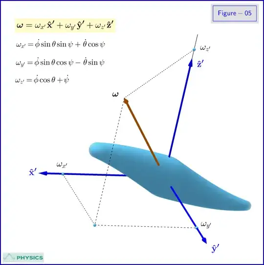

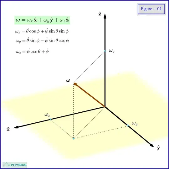

Moreover in \eqref{Table-01} we see the coordinates of the angular velocity $\:\bl\omega\:$ in the space frame $\:\bl{xyz}$ \begin{equation} \begin{split} \bl\omega&\e\omega_x\,\mathbf{\hat{\mathbf x}}\p\omega_y\,\mathbf{\hat{\mathbf y}}\p\omega_z\,\mathbf{\hat{\mathbf z}}\\ \omega_x&\e\:\dot{\!\!\theta}\cos\phi\p\:\dot{\!\!\psi}\sin\theta\sin\phi\vphantom{\dfrac{\tfrac{a}{b}}{b}} \\ \omega_y&\e\:\dot{\!\!\theta}\sin\phi\m \:\dot{\!\!\psi}\sin\theta\cos\phi \\ \omega_z&\e\:\dot{\!\!\psi}\cos\theta\p\:\dot{\!\!\phi}\\ \end{split} \tag{B-20}\label{B-20} \end{equation} shown in Figure-04. Note that equations \eqref{B-20} are identical to those in DERIVATION 15, page 182 in the Reference.
In \eqref{Table-02} we see also the coordinates of the angular velocity $\:\bl\omega\:$ in the body frame $\:\bl{x'y'z'}$ \begin{equation} \begin{split} \bl\omega&\e\omega_{x'}\,\mathbf{\hat{\mathbf x}'}\p\omega_{y'}\,\mathbf{\hat{\mathbf y}'}\p\omega_{z'}\,\mathbf{\hat{\mathbf z}'}\\ \omega_{x'}&\e\:\dot{\!\!\phi}\sin\theta\sin\psi\p\:\dot{\!\!\theta }\cos\psi \\ \omega_{y'}&\e\:\dot{\!\!\phi}\sin\theta\cos\psi\m\:\dot{\!\!\theta }\sin\psi \\ \omega_{z'}&\e\:\dot{\!\!\phi}\cos\theta\p\:\dot{\!\!\psi}\\ \end{split} \tag{B-21}\label{B-21} \end{equation} shown in Figure-05. Note that equations \eqref{B-21} are identical to those in equation (4.87), page 174 in the Reference.
